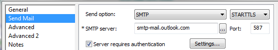

J-D-H - For some reason I am having problems with MSN accounts sending messages right now using "SSL/TLS" but I am able to send successfully using "STARTTLS".
So I would suggest that you change the "Send Mail" settings to use "STARTTLS" (doing this will automatically set the Port to "587", do not change the Port setting).
Example "Send Mail" settings that should work:
Try these "Send Mail" settings
Webmail automatic send settings.png (8.02 KiB) Viewed 8960 times
I'm assuming that you are able to receive incoming messages since you started using WebMail ("Hotmail/Outlook" Server setting) and that the only current problem is that you are unable to send messages, is this correct?
It appears to me that you should have been able to receive messages regarding your initial post with the settings you had using Port "995" with "SSL/TLS" using the "POP3" protocol but the error you were getting involved sending messages so I'm assuming the initial post involved this problem (which the above settings should address). Apparently at some point you later changed the Port to "993" which would be the incorrect port using "SSL/TLS" with "POP3" for receiving messages but regardless it appears you have since changed protocols once again regarding the last two posts and are now using the Webmail protocol (which I'm assuming now works for incoming messages).
As spc3rd pointed out, your Port setting changes would have impacted incoming messages during the time when you were using the POP3 protocol at some point before eventually switching to Webmail.
On that point J-D-H, when you change protocols ("Server type" to either "IMAP" or "POP3") are you changing other settings than just the "Server type"? I ask this because these other settings are automatically set so you should not have to change them (i.e. the Port settings) when you change protocols.
Please post back if you are still having problems receiving messages and more specifically sending messages using the above "Send Mail" settings.

Boy, you sure nailed it. I kept looking and looking at my settings, but for some reason I always "saw" SSL/TLS as STARTTLS. And I had already checked the Outlook/Hotmail website (several times, actually) and knew that STARTTLS was the correct setting! So now I feel like a real goof. Regardless, apologies to all here who tried to help. The problem was "selective symbol interpretation" all along! :-)
