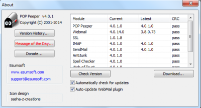

Some of my hotmail accts work, some PP won't display anything. What should I fix? I just updated PP here is the info:
Re: More Hotmail problems

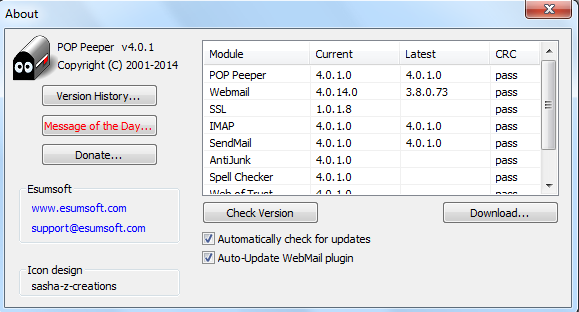

You have said you "... just updated PP", what was it that you "just updated"? (if it was an update to PP v4 then you may have an installation problem, see "*" comments below)
If you CLICK HERE and scroll down to "Webmail plugin" you'll notice that Webmail version 4.0.19 is the current version and as stated (scroll down to "Webmail" plugin) this Webmail plugin update involves the "new 'Outlook Mail' interface": v4.0.19 (Sep 14, 2015) - Hotmail/Outlook.com: Basic support for new 'Outlook Mail' interface (unsupported: compose, attachments, folders)
If you're using "Webmail" (that is using the "Hotmail/Outlook" Server-type) which I presume you are then you'll need to be up to date with the most current Webmail plugin just released 10 days ago.
To do this perform these four steps:
1) From the main menu, go to "Help" > "About Pop Peeper" in your PP main interface.
2) Make sure that both "'automatically check for versions" and "auto-update webmail plugin" are enabled (checked).
3) Click on the "Check Version" button.
4) POP Peeper should hopefully discover the new version and update it. (also hopefully doing this will correct other abnormalities you have displayed in your PP module list (re: missing latest versions) and you'll be all set, see comments below)
* You'll notice that your Webmail version is quite old and the "Latest version" is incorrect in "About Pop Peeper" (should be v4.0.19, but is instead represents the old version of PP and it is noted that other modules are blank all of which is incorrect), if the above steps fail to work then you may need to perform a manual update of this plugin (this does NOT apply to most users who just need the latest Webmail update). For instructions on how to do this CLICK HERE, scroll down a bit and follow the instructions "To Manually Update the Plugin". QUESTION: If you just updated PP to from version 3 to version 4 then would you please post where POP Peeper was installed (i.e. C:\Program Files (x86)\POP Peeper\)? And can you also post what Windows OS you have (i.e. Windows 7)? (if you're not sure where PP was installed then take a look in "Tools" > "Options" > "Storage"). Have you by chance renamed any DLL's where your PP is installed?

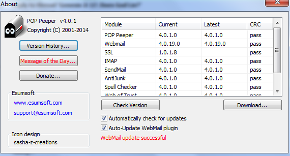

Post by username111 »
Ok that worked but all emails are highlighted for some reason and when I try to send I get an error 0 error.

Would you please post the "About Pop Peeper" image again like you did before?
sure
