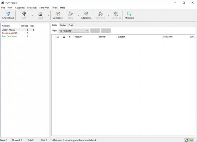

I got the problem that I can't see messages in the inbox even with "All Accounts" and "Show all" activated.
In the left field with my accounts I can see that there are 4 Unread messages and 3 New messages in the mailbox, but they are not listed in the Inbox.
I'm using the version 4.0.1
Does anybody have an idea how to fix my problem?

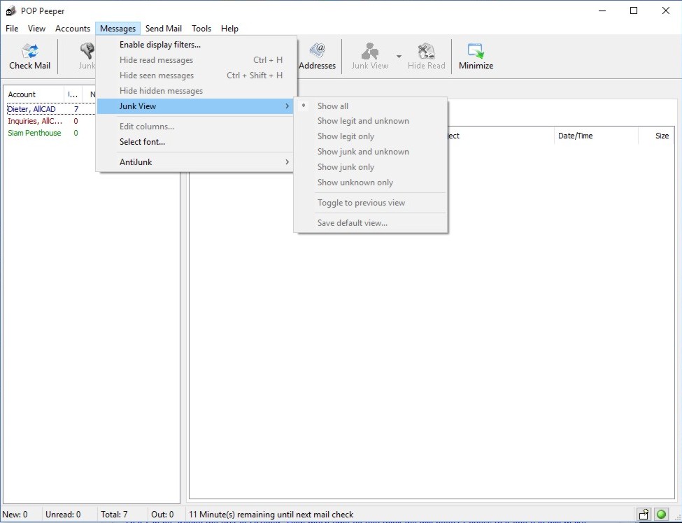

Hi and thanks for your quick response :)
Unfortunately did it did not work.
"Messages > Hide hidden messages" is off
"Messages > Enable display filters..." is off
"Messages > Junk View > Show all" is selected
"View: *All Accounts*" is set
but Account shows 12 Unread and 1 New message which I still cannot see :(
What else could be wrong?

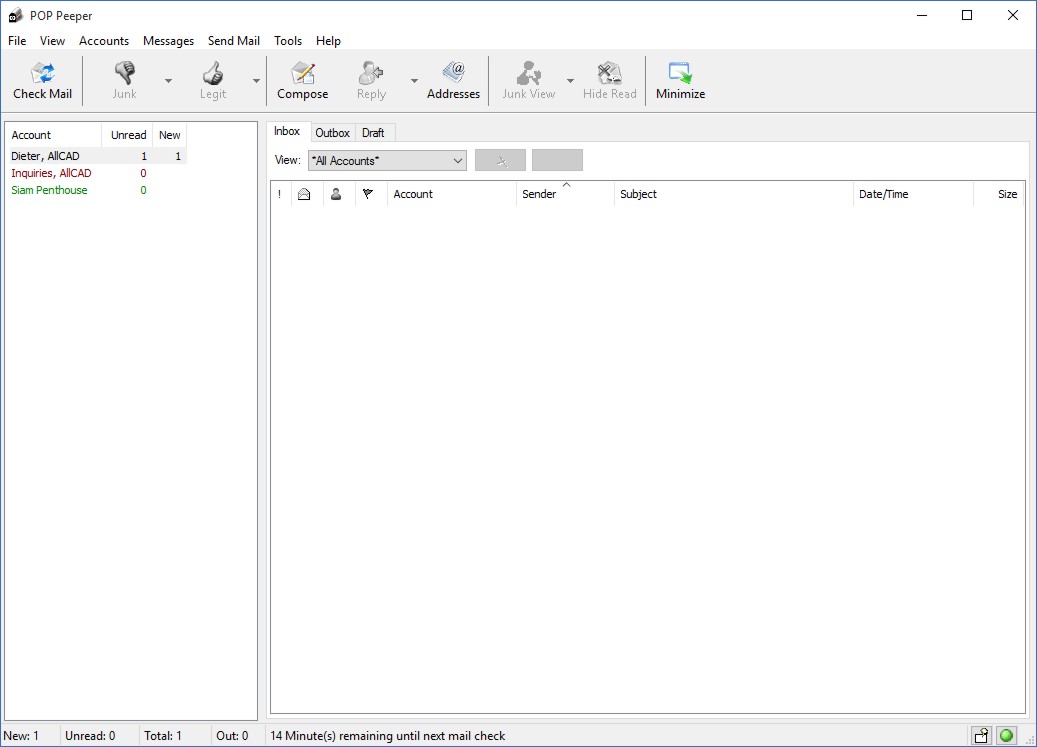

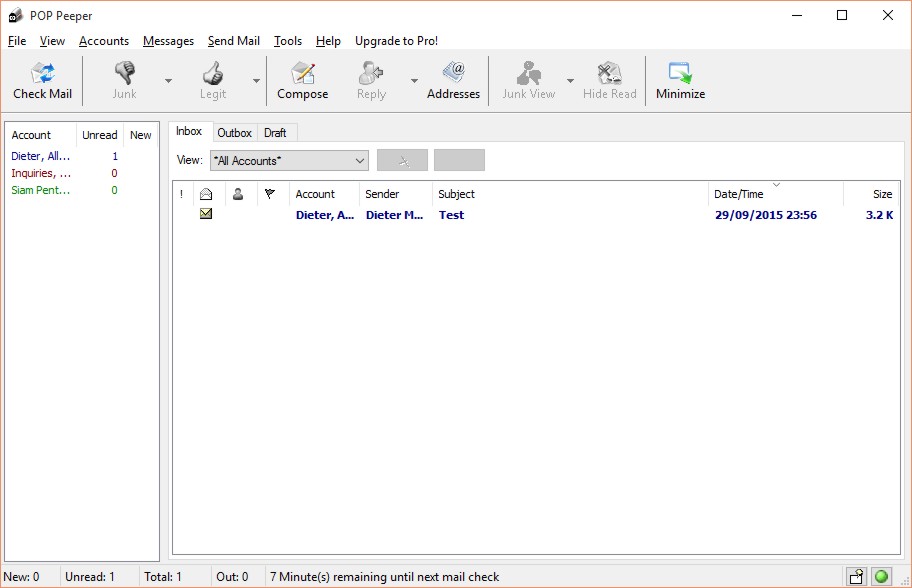

On my main PC there is the fully licensed POP Peeper Pro installed. On this one I got the problem.
On a second PC there is only the free version running, but with the data from my main PC. On this computer everything looks fine. Both computers are running Windows10.
Second PC with POP Peeper standard
Main PC with POP Peeper Pro

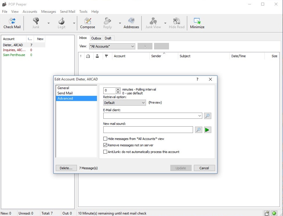

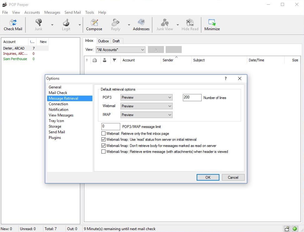

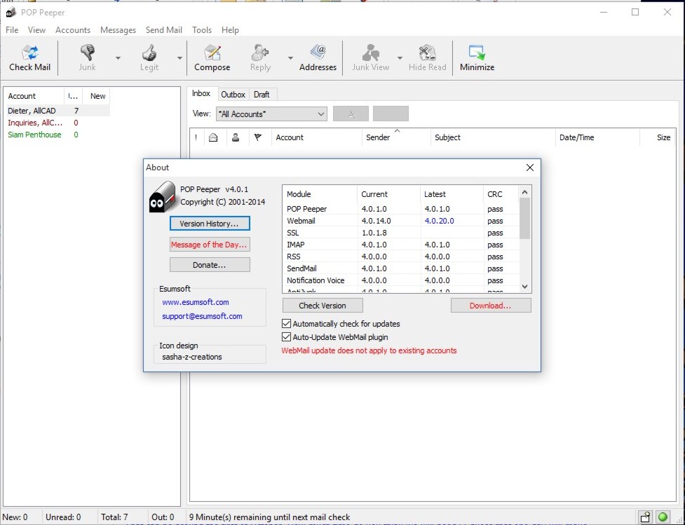

Hi Jeff,
sorry that I have to bother you again, but the problem is back :(
Attached can you see the screen shots of all the relevant settings, which you let me check the day before.
Unfortunately I cannot add all 4 screen shots. The last one can come with the next message. It shows the Messages Menu.
I could copy again the settings from the other computer, but that cannot be the solution for the future.
Sorry again
Dieter
Advanced Account settings
Message Retrieval settings
About Window
About Window
