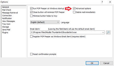

Also here's a screen-shot (that I've added) to offer more detail regarding the enabling of the "Advanced" option:
Make sure the "Advanced option" is enabled by way of checking the box.
