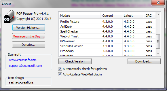

I do not see an option here to upload a jpg, but my versions say:
Webmail 4.4.1.0 4.4.4.0 pass
Profile Picture 4.2.0.0 4.3.0.0 pass
all other rows are current versions and say pass as well.
I did the upgrade manually. I downloaded the file and clicked on it to run it. When things looked awry, I realized that the instructions are to place it in the programs folder and restart POP Peeper, so I did that as well, which had no effect. I also tried checking Automatically check for updates and Auto-Update WebMail plugin. I left them checked for a while yesterday, and it had no effect.

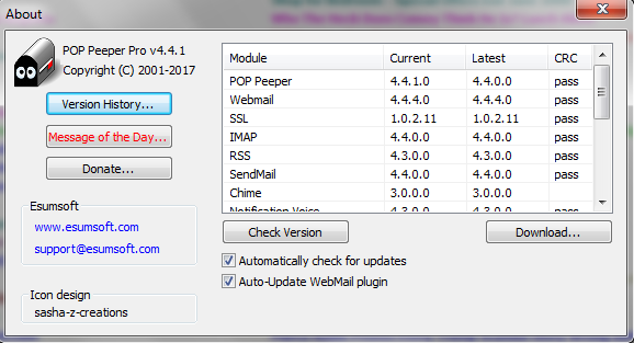

Now, I have the right version. I had downloaded the exe instead of the zip file with the dll.
The exe file does not work properly. I put the dll in my POP Peeper installation folder, and now it works.
Re: All Yahoo and SBCGlobal Accounts Timing Out While Webmail Works

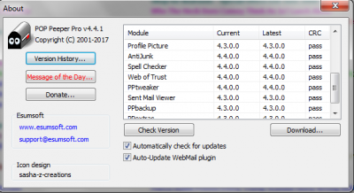

You should be okay if your "About POP Peeper..." looks like this:
