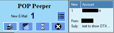

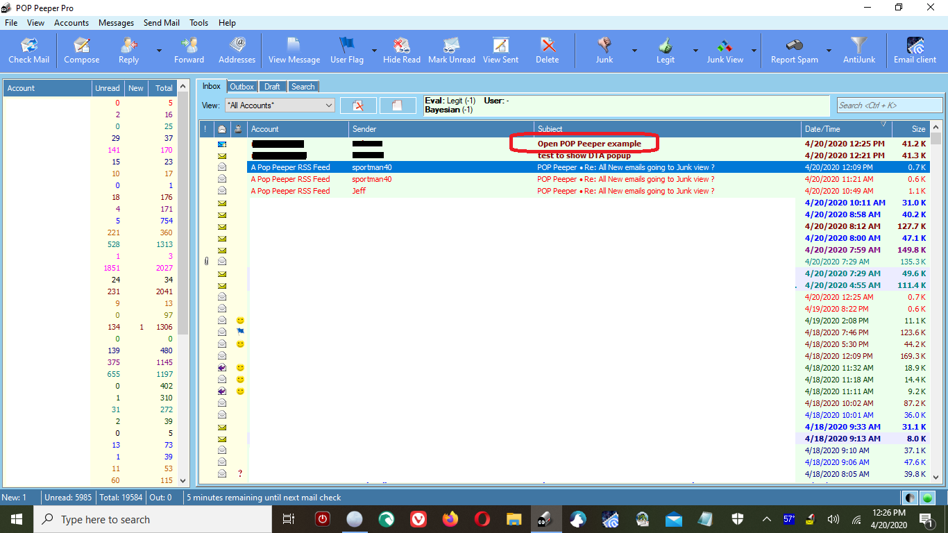

First of all -- I'm not sure this is what you were asking about -- but here are the two examples illustrated by screen-shot results below.
Regarding the Tools > Options > Notifications: "When I receive new mail" setting (in Visual section of window):
1) Set to "Display Desktop Alert" screen-shot example (possibly what you are currently using):
This is what is typically (usually) used for this setting
PIC-1 DTA POPUP EXAMPLE.png (8.14 KiB) Viewed 27064 times
2) Set to "Open POP Peeper" screen-shot example:
This is the option that I was asking if this is what you meant by your question.
Is the second setting (option #2 above) example what you were asking about? -- when you posted:

lakrsool regarding the Tools > Options > Notifications: "When I receive new mail" setting (in Visual section of window):
I did try this when I did it and I use my browser every time Notifications: "When I receive new mail" setting (in Visual section of window): it comes on top of my browser is their a way to make it pop up to the desktop ?
this second (#2) option I do not get please tell me about it ?
sportman40 wrote: Mon Apr 20, 2020 4:10 pm lakrsool regarding the Tools > Options > Notifications: "When I receive new mail" setting (in Visual section of window):
The DTA does popup to your desktop (this is the function of the DTA) and does so in foreground -- that is on top of other stuff (i.e. your open browser). This is what it should do so that you can see the Notification for new messages. If the DTA popup were in background -- that is behind or underneath other stuff (i.e. behind your open browser) then you would not see your Notifications for new messages. So you would not be aware that new messages had arrived if it were "hidden", so to speak, behind other open windows. There is no practical or logical reason that you would want the DTA to display any other way than it does now -- so this is the way the DTA works (that is it will display "on top" of other stuff you have open) and cannot and should not be changed from performing this way.
sportman40 wrote: Mon Apr 20, 2020 4:10 pm this second (#2) option I do not get please tell me about it ?
It appears this is probably not what you were asking about (I assumed so because you must already have a new message notification that you have been using hence my assumption that perhaps was you original question). Perhaps you can clarify what exactly was your original question? :?
To put it simply -- instead of the DTA popping up when new messages arrive (probably what you may be currently using) what you will get instead is POP Peeper (main interface window) opening up so that all of your messages will display that are in your inbox including the "new" messages" at the time new messages arrive. To clarify further -- this is the same thing as when you click on the POP Peeper icon to open the main interface to see your messages (I have redacted [removed] a lot of this in my former example screen-shot). If this remains confusing to you -- please disregard this option and stay with what you have been using up until now. :D

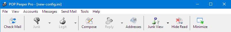

I have 9 messages a new one comes in 10 messages I open pop peeper to see the 10th new message is not in my inbox until I click on junk view I also see the same thing in junk view as I see in my inbox every email is mostly green same in both inbox and junk view it did not ever work like this the fix is ? can you show me both you set ups
PPv4_DefaultToolbar.
How many accounts do you have in POP Peeper?
Without actual screen-shots it is difficult to know exactly what you are doing and what the results you are getting when you do it.
Please verify each step you have described in your example description that you just posted - PLEASE answer either "Y" or "N" to each question line below that needs a "Y" or "N" answer and include more information if the answer is "N":
01) You "have 9 messages" -- this means you have a total of 9 messages in your POP Peeper In-box -- is this correct (Y or N)?
If "N" please explain more about what you happened.
02) You know this because the last time you opened POP Peeper you recall there were 9 messages -- is this correct (Y or N)?
If "N" please explain more about what happened.
03) "a new one comes in" as you mentioned (and you know this because of the "new" message notification you get from Pop Peeper -- is this correct (Y or N)?
04) You "open pop peeper to see the 10th new message" (so POP Peeper was closed and you do what to open POP Peeper?)
05) When POP Peeper opens you are looking at the messages in the "In-box" and you only see 9 messages and do not see the 10th "new" message -- is this correct (Y or N)?
06) You then click on the "Junk View" button (same button displayed below) -- is this correct (Y or N)?
07) "which is empty" means that you do not see any messages in the POP Peeper In-box -- is this correct (Y or N)?
08) "I close pop peeper" you are doing what to "close" Pop Peeper?
09) then "open it back up" you are doing what to "open" Pop Peeper?
10 When Pop Peeper opens you then see 10 messages instead of the 9 you had previously seen in the Pop Peeper Inbox -- is this correct (Y or N)?
Questions 1-3 and 5-7 and 10 should have either "Y" or "N" answers and if there are "N" answers please explain more about your "N" answer. The other questions would need explanations.
Each can be posted by just including the number and the "Y" or "N" or explanation reply such as the answers might be: 01) Y and 02) N and 03) N and so on etc etc etc. (the "N" answers would need an explanation why the answer is "N".
Sorry -- but without screen-shots; speaking for myself I'm not totally clear exactly what is happening based on what you're describing.
I am now able to leave a screen-shot of the "Junk View" button for reference:
Junk View Button.png (1.07 KiB) Viewed 27010 times
