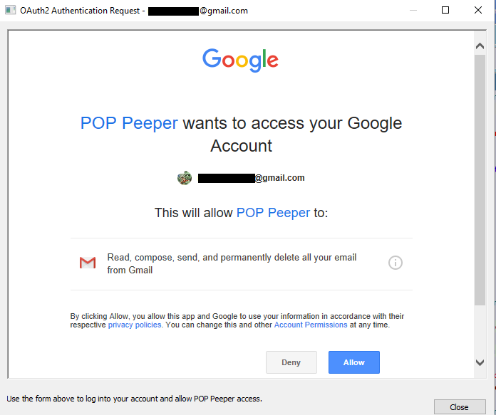

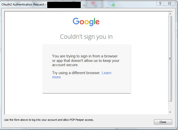

I am no longer able to use OAuth2 with Pop Peeper. Whenever I click the OAuth2 button to authorize an email account, I get the following screen after entering into a form the email address and password for the account:
One oddity I've noticed is that although I use Chrome exclusively, this window you are seeing is coming from Internet Explorer. When I right-click within the window, the context menu clearly identifies it as an Internet Explorer window. So one question I have is, why is Pop Peeper launching an Internet Explorer window instead of a Chrome window?
I've never before had any problems using OAuth2 with Pop Peeper. Each of my Pop Peeper gmail accounts have been created the same way. Here is an example:
Again, this all used to work fine.

In regards to the observation you made about Internet Explorer (IE). This involves IE emulation that is required by PP to for the most part display HTML messages and as of v4.1 PP was upgraded to emulate whatever version of IE you have.

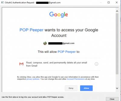

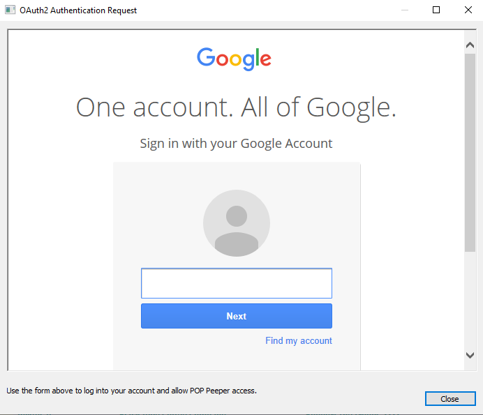

Thanks for taking the time to provide all of that information. Image ... and sorry for the delay as I've been out.
I'm unable to find any reason why you would have an issue where the first OAuth2 step would render a blank page as you have described. Changing the password on an account should not have any impact on the OAuth2 PP authentication process. To confirm you are saying that you do not get this first OAuth2 PP authorization page as illustrated here:
Is that correct -- you just get a blank page (instead of what you see in the screen-shot above)?

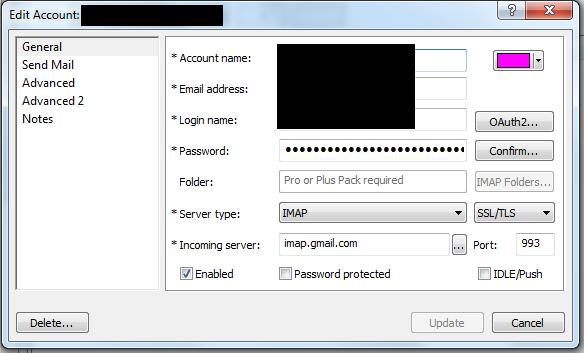

The only thing I see is that it appears you do not have the "Send option" setting set to "SMTP" in the "Send Mail" window (when editing the account) but as far as I'm aware this would not have any impact of any kind on the OAth2 process anyway.
While changing the password should not produce the issue you describe -- I've gone ahead and tested a Gmail account by changing the password and re-authorized the account (even switched back-and-forth between protocols) and I am unable to duplicate the problem. That said, I am using a beta version of PP so I can't say how meaningful my test results actually are.

I indeed have a blank page and not the google page.

^ Interestingly -- I woke up this morning to the same exact error with the Gmail account (I previously used to test the problem) you were getting Roman as illustrated below:
Your error (you previously posted):
Roman wrote: Sun Jan 19, 2020 3:54 pm --- Error ---
[1000: IMAP] ['imap.gmail.com' (993) SSL: 1] [ClientSend: '' (0) SSL: 0] [consec: 1]
- Error ([AUTHENTICATIONFAILED] Invalid credentials Failure)
My error this morning (~time of posting):
[1000: IMAP] ['imap.gmail.com' (993) SSL: 1] [ClientSend: '' (0) SSL: 0] [consec: 27]
- Login Error ([AUTHENTICATIONFAILED] Invalid credentials Failure)
-- Edit account: pp://EditAccount?bWlrZXNpbmJveHh4IEc=
... As you can see the bolded/black text in both cases are identical (as I was attempting to duplicate your error that didn't start occurring until about 5½ hours ago).
Notice my "consec: 27" which, as I mentioned, means the error started and remained persistent about 5½ hours ago (since I have PP set to do scheduled Mail Checks every 12 minutes [~324=~5½ hours]). That last bit in blue has been added in PPv5 thus is displayed in my beta version of PP (so you wouldn't get this with your current version of PP) -- it is the parts of the error in bold/black that are identical.
This is the Gmail account that I had used to test your issue. And what I've found this morning is that I was still able to re-authorize POP Peeper successfully which ultimately cleared the error in my case. I did notice that the first step rendered a blank page for about 3 seconds before getting the first step to login to Gmail to display (it seems in your case the PP Authentication hangs prior to the first login step). You should be able get past the two login steps (ID/Password) to this next step (as I do in the screen-shot below) to get Gmail to "Allow" POP Peeper access (why you don't remains a mystery :?):
... hmm, makes me wonder if my PP beta version could be a factor....
