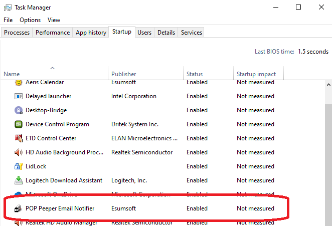

Just to be clear -- using the Windows Task Manager (ctrl+alt+del) you do get the following circled in the startup tab?

Windows Task Manager has the PP entry.
