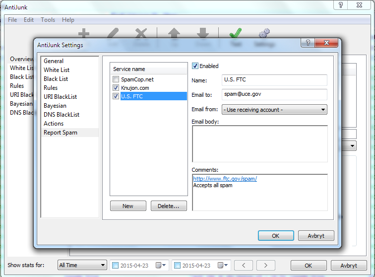

If I uncheck "U.S. FTC" Pop Peeper crashes with error code: 0xc0000005
If I Enable it again, Pop Peeper work as it should.
I have the latest version 4.0.1.0 and webmail 4.0.14.0.
I attach a picture of that I mean.
Tomas

I'm not able to duplicate the problem. At what point does POP Peeper crash? e.g. as soon as you uncheck it, when you perform a checkmail, when you try to report spam, etc.?

I was then I were trying to view message (Retur), now is it then i uncheck "Knujon.com" and "U.S. FTC" and after that I try to view message (Retur)

Ok, I'm able to duplicate it now -- if NO reporting services are enabled, then PP will crash when you try to view a message (whether the "report spam" button in on the toolbar or not). I'll fix this.
In the meantime, just keep at least one of the services enabled and you should be fine. There's really no reason not to disable all of them, POP Peeper won't use the services unless you specifically report an email.
