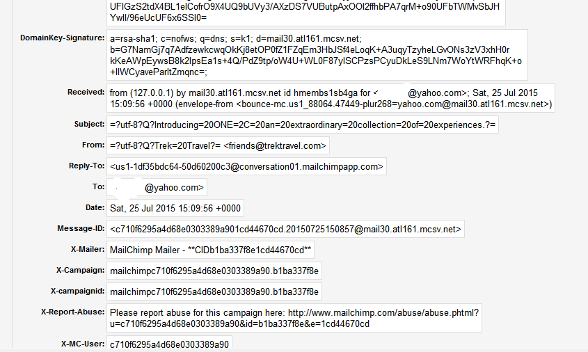

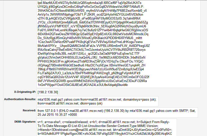

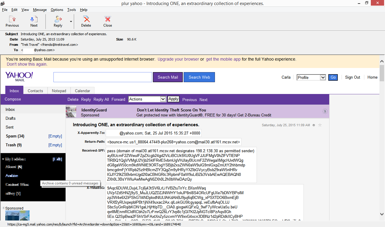

For a few months now some of my Yahoo accounts are displaying in POP Peeper with all of the headers/details showing (X-Apparently-To:, Return-Path: , Received-SPF: ,X-YMailISG: , X-Originating-IP: etc.) with the following error message:
You’re seeing Basic Mail because you’re using an unsupported Internet browser. Upgrade your browser or get the mobile app for the full Yahoo experience. Don't show this again.
When I click to "upgrade" it takes me to the Firefox update page however mine is already up to date. When this issue started happening in May only some of my Yahoo accounts were affected, now all of them are displaying this way. I have not updated any of the Advanced settings. Screenshots below and attached (there are 4 screenshots but it seems I'm only able to attach 3).

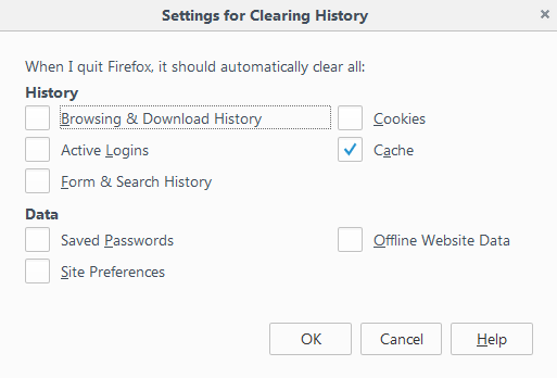

Btw, what I do in FF with "Clear history when Firefox closes" setting checked that you'll find in the "Privacy" menu the following (see image below) setting (I find this can sometimes avoid issues loading pages by doing so, that said loading pages can be a tad slower as a result so depending upon your connection speed the choice is yours. Keeping in mind that I NEVER want to clear cookies however (if I can help it) because I depend upon many various settings for logins, page settings etc that rely on cookies (if you don't rely on cookies and the problem persists you could try removing [clearing] all cookies if you like by using the "Remove all" button in the "Show Cookies" window in the FF "Privacy" settings menu and see if this helps and if so you could also check the "cookies" selection below if you wanted to us this setting when closing FF if you like to avoid future issues. That said, this setting below is not critical at all but totally based on user preference.)

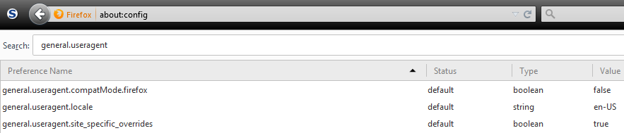

3) In the "Search" filter type "general.useragent" without the quotes (you should see the same as what you see in the image below, if so you can skip the next step #4 below).
4) If any of the three preferences are displayed in BOLD characters then it is a "user set" preference so in that case right-click on those that are displayed in BOLD and select "Reset" from the context menu (if the settings are already set to "default" [non are BOLD] then the "Reset" in the right-click context menu will be disabled [grayed out]).
In the end you should see the following preference settings in your about:config:
about config settings re useragent.png (10.02 KiB) Viewed 13462 times

Posts: 9441
Re: Yahoo - all details showing/Basic Mail/Unsupported Brows
There are 2 potential solutions to this problem:
1) As you've already discovered, use IMAP (or POP3) to access the account
2) Make sure that POP Peeper is not displaying the entire web page:
in POP Peeper v4: main menu: Tools / PPtweaker / Misc: "When viewing messages, show entire web page (webmail only)" should be DISABLED (disabled is the default; previous to v4, this option was under Tools / Options / View messages)
This will remove the headers and the "unsupported browser" notification.
For the record, your default webbrowser has no effect on this issue.
