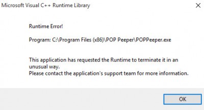

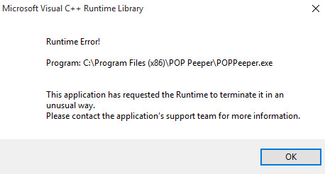

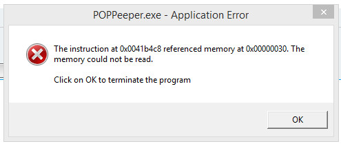

I've done the upgrade (and the other checks, which were fine) and I'm afraid it's not helped. In fact it seems even worse. Now opening around one in five messages in default HTML, or opening in plain text message and clicking on the HTML view simply causes PP t crash....
Re: HTML rendering in POP Peeper
ECourts wrote:I've done the upgrade (and the other checks, which were fine) and I'm afraid it's not helped. In fact it seems even worse. Now opening around one in five messages in default HTML, or opening in plain text message and clicking on the HTML view simply causes PP t crash....
Has PP been crashing during "Mail checks" also or does PP only crash when you open a message?
When PP crashes do you get any type of message from Windows at the time?

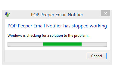

It crashed when attempting to view a message. Previously I had HTML as the default view when opening a message and it regularly crashed when the message window opens (or more accurately the message window opens, there is pause with a blank window, then it falls over. It fails similarly if the default viewing is text, but I try to switch an open message to HTML view. No useful error message:
This is Windows 8.1 with IE 11.0.9600.17905 (which I don't normally use)
