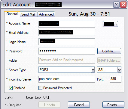

Just set up a new email at Zoho.com which works fine with my email client but with PopPeeper I get a "Login Error (OK)". I'm using the same config on PopPeeper as my email client. I've attached a screenshot of my PP config. I'm using PP 3.8.1 on XP SP3.

So I downloaded & installed 4.0.1 and got a SSL error. Downloaded the plugin and now PP 4.0.1 gives me the exact same failure and error message as 3.8.1. Here's the error report:
OS: Windows XP
POP Peeper: 4.0.1.0
Webmail: 4.0.14.0
SSL: 1.0.1.8
IMAP: 4.0.1.0
SendMail: 4.0.1.0
AntiJunk: 4.0.1.0
Spell Checker: 4.0.1.0
Web of Trust: 4.0.1.0
--- Web Test ---
Result: 200
Error:
Time: 21:37:33 - 21:37:34 (1 s) (-0700)
Data: Sun, 30 Aug 2015 21:37:33 -0700
xxxx@ Zoho [0: POP3] ['pop.zoho.com' (995) SSL: 1] [Smtp: 'smtp.zoho.com' (465) SSL: 1]
Login Error (OK)
Posted email address redacted for security reasons - lakrsrool
