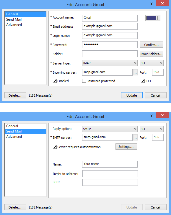

i still have issues with 5 accounts, i have enabled IMAP , however it doesn't seem to want to work on different accoutn, worked on first. am wondering if on microsoft edge it works off the original cookie from the sign in and therefore if the old cookie is in it won't respond to a different gmail account.
and then i have tried re-adding those accounts
but when i check for server i get this

Re: problems again with pop peeper - gmail access
pop_pepper --
Don't bother using the Find/Discover Server function for GMail -- POP Peeper will automatically use the correct settings without having to use that. If you want to compare, see this:
http://www.esumsoft.com/images/PP_GMail_Settings.png
Furthermore, I have found and fixed the bug that caused the correct settings to return "Bad Connection" in the Find Server.
If POP Peeper still returns an error (when using a real check mail) using the correct GMail settings, let us know what the error is.
(Sorry for your original topic getting hijacked)
