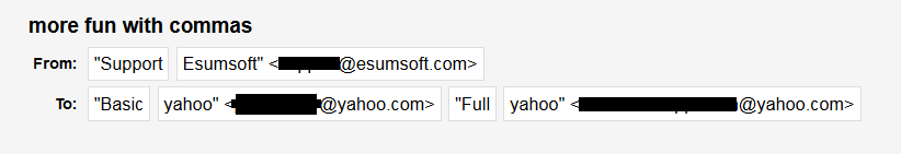

Ok. The problem originates on Yahoo's end. I sent a test message to 2 of my Yahoo accounts (one that uses the basic interface, the other uses the full interface). I included a comma-infused name in the "from" and the two "to" names. This is what the message looks like when I view the message with my webbrowser (ie. http://mail.yahoo.com):
The correct names should be: "support, esumsoft" and "basic, yahoo" and "full, yahoo" but, as you can see, Yahoo parses them incorrectly and since POP Peeper gets this same bad information...
So, I have a fix. This is a rather specific fix and I don't claim that it will work in every case, but it should work in the most common cases. This will also fix a problem with the 'to' address which was originally faulty anyway (for basic interface), but one caveat is that the commas will be removed (ftr, the comma WILL be in the 'from' address).
