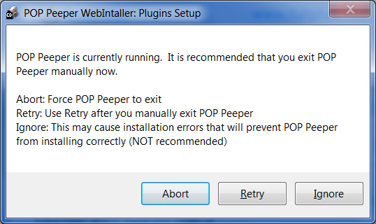

That's the prompt that the SSL installer shows if PP is running when you try to update SSL.
I don't see what the problem is? :?

I was referring to an attempt at manually installing SSL from a zip, not through web installer.
Oh and I noticed a typo in your dialog's titlebar: WebInstaller.
Posts: 9252
Re: SSL in 4.4 beta
Drugwash wrote:I was referring to an attempt at manually installing SSL from a zip, not through web installer.
Ah, ok, I had forgotten about that method (I was thinking of manually extracting the contents of the zip file). I've updated the text.
Drugwash wrote:Oh and I noticed a typo in your dialog's titlebar: WebInstaller.
:shock: Thanks. Updated.
