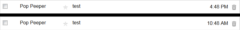

I think I may have seen this issue before but, at the time, I may have thought it was a bug in Yahoo. Here's why:
When I sent my Yahoo/basic account a message and logged in, the inbox showed me the same timestamp that PP did -- 6 hours in the future. Only after I (open the message / refresh the inbox / something), does the inbox correctly show the time. This repeats itself each time I logout and back into the account.
Before & After screenshot:
Same email; before & after
