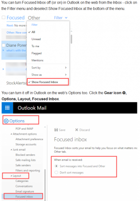

Alternately if you want to continue to use the Webmail protocol then you will need to disable this feature in your Hotmail account on the web by clicking on "
Filter" to
disable the "
show focused inbox" option or alternatively accomplish the same thing as illustrated below using the accounts "
Options" page (refer to screen-shot below, click to enlarge for better readability).
This is because POP Peeper does not currently support the Hotmail filtered inboxes via the webmail protocol that the new Hotmail interface uses.
- Examples of how to turn off the Hotmail accounts "focused Inbox" filter.
(allowing the continued use of Webmail protocol)
