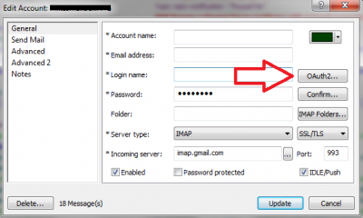

Are you using OAuth2 for these IMAP accounts?
If you are not sure or do not know, edit the accounts and click on the OAuth2 button to the right of the interface and follow the steps to authorize PP. (it is also recommended to enable IDLE/Push for IMAP accounts which among other things helps reduce the number of log-ins which is good because a high frequency of log-ins can sometimes trigger Gmail to consider this as "suspicious" activity).
Are you able to successfully log-in to Gmail on the web?
It may be that Gmail is simply requiring you to answer a question.

This is the button I am referring to:

Nothing above "Confirm" just a blank space....

Re: Having log in problems with 2 Gmail accounts
Great, were you using v4.4.1? If so the OAuth2 button should have been visible for your Gmail accounts using IMAP.
