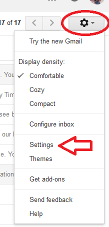

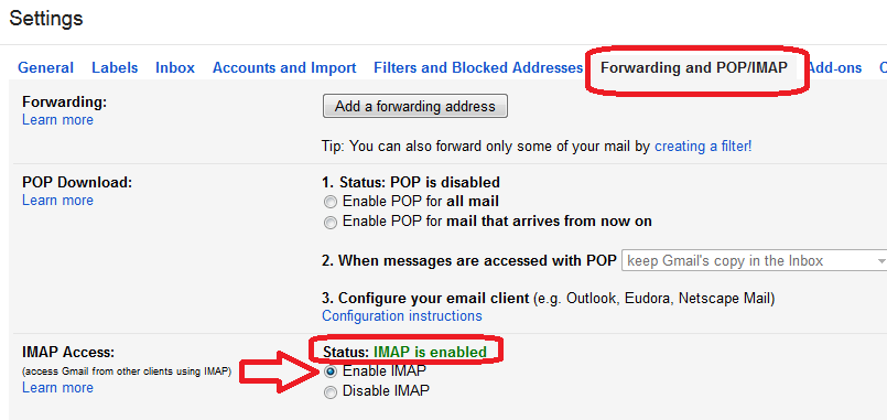

One other thing you could check when you are logged-in your Gmail account via the web.
Check to make sure you have "IMAP" enabled in the "Forwarding and POP/IMAP" tab of Gmail Settings (as illustrated in the screen-shot):
Click to enlarge if needed for better visibility of the image (to return to forum after viewing enlarged screen-shot just page your browser back to previous page)
You access Gmail Setting via the "gear" icon in your inbox page:
go to settings in Gmail.png (11.13 KiB) Viewed 12069 times

IMAP is selected on the Gmail account, yes. I even turn it off, save, and on again then save.
