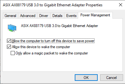

Attached are my Ethernet card's (default) settings. Note it's an external USB card.

When I wake up the computer, it takes a minute or two to have the Ethernet icon stop having a red X.
Have you tried enabling the "allow the computer to turn off this device..." setting and then, enable the "allow this device to wake the computer"? Perhaps that would allow the device to come back into service more quickly (just an idea, with nothing to support it; just something I would experiment with myself).

lwc wrote: Tue Feb 11, 2020 1:01 pm I'll try your suggestion!
I've tried it and it took 40 seconds to get the connection back, which I guess is better than before.
But I miss having it back instantly...
Keep in mind it's 40 seconds not including the time it takes to wake the computer itself, input the password, etc.
ethernet power settings.png (9.96 KiB) Viewed 12566 times

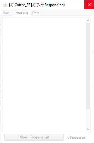

A quick search in https://www.portablefreeware.com/index.php?q=sleep&m= (some of these results do what you plan to program) gave me http://coffeeff.sourceforge.net
It's quite old (last updated in 2015) and gets stuck when it tries to let me choose a program to monitor.
At one point I did manage to see PP in there, but seconds later it got stuck.
The point is other programs do have a "prevent sleep" option right in them, not requiring an extra program to do it for them.
coffee stuck.png (6.23 KiB) Viewed 12555 times
