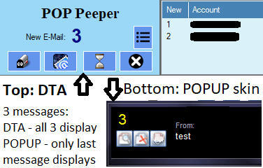

Looking at the screen-shot below -- I've described what occurs for each of the two types of message alerts. As you can see both will provide the number of messages however when it comes to displaying the specific messages you can see that the DTA will continue to display ongoing accumulated messages in its dialog interface as opposed to the POP skin that will only display the last message retrieved.
As I see it the POP-Up skin is intended to alert that messages have arrived but in the case of leaving the alert displayed there is less of an advantage because not all subsequent messages will get displayed anyway for the POP-UP skin as is the case for the DTA.
So it seems to me that the DTA lends itself better to keeping the alert displayed over a period of time when numerous Mail Checks would occur as opposed the the function of the POP-Up skin that does not provide as much information regarding multiple messages that get retrieved while the alert remains displayed.
I'm personally not that familiar with the various POP-Up skins. There may be other POP-Up skins that other members of the support team can recommend that can serve you better to keep displayed over time.
Because the DTA defaults in the lower-left position of the desktop (DTA can be alternately positioned anywhere) and the POP-Up skin you are using will display in the lower-right of the desktop you can use both of the alerts at the same time to make a comparison as far as what each alert provides as far as your preferences are concerned. The DTA can be enabled under Tools>Options>Notifications in the "Visual" section of the window, which is btw -- the alert I use myself -- because like you, I do prefer the alert to remain visible until I dismiss it and with that I prefer a list of all retrieved messages to be displayed in the alert over a period of numerous Mail Checks (this way with the DTA -- I am able to easily observe all new messages retrieved in the alert in cases where I'm away from the computer over longer periods of time).
Example:
DTA vs POPUP skin.png (19.44 KiB) Viewed 6046 times
