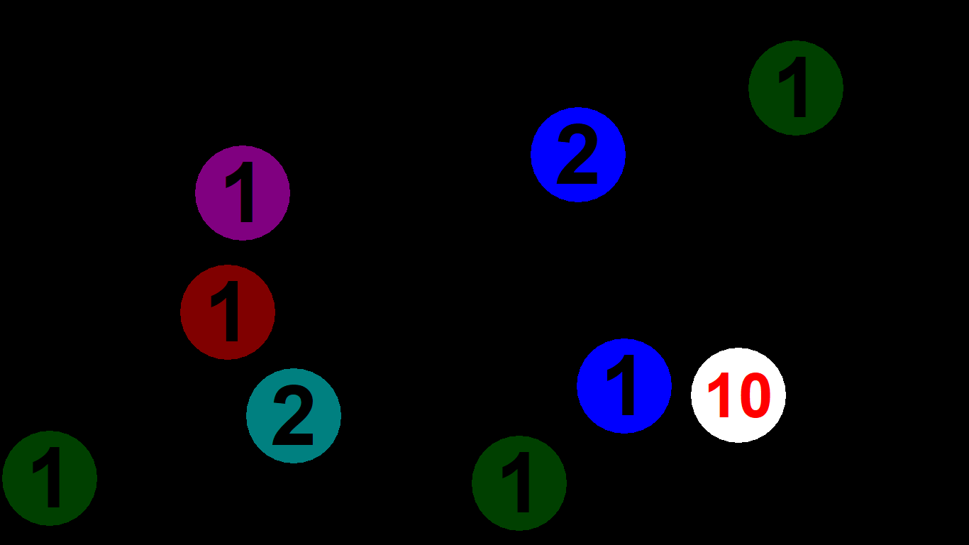

I've never used the PP screen saver -- so I installed it to test (it appears to work as intended -- assuming I'm understanding the intent :wink:).
First in the description of the screen saver (link: https://www.esumsoft.com/products/pop-p ... inNotifier) it states: "When the screensaver activates, this plugin shows how many messages each account has with bouncing balls".
Based on my testing this reference to "how many messages" means how many retrieved (new) messages (while the screen saver has been running).
So perhaps the description should read something like: "When the screensaver activates, this plugin shows the bouncing balls for each of the the accounts that have retrieved new messages".
Anyway -- it wasn't easy to test because you have to have the screen saver running when the new messages get retrieved.
As a test I sent 10 messages using various different accounts from one computer to another that had the screen saver on and got this result below:
So it does appear to work for me. I tested 7 different accounts some with multiple messages. It appears there are 5 accounts represented which could be explained because perhaps not all of the accounts messages have been retrieved at the time I captured the screen-shot (there were in fact more messages that were retrieved after I took the screen-shot) so I can't attest totally to the results (but from a cursory examination it does appear to look good to me).
Not ever using the screen saver, at first -- I wasn't sure what the white ball (starting out with the zero in it) represented. But I can see this represents the total number of new messages that have been retrieved while the screen saver is running and each of the other balls represent various different accounts with the number of retrieved messages for each account displayed in each of the different colored balls.
So perhaps you were thinking that the balls should represent messages for each account and not "new" messages. If so -- if you test the screen saver for "new" messages (while the screen savers is running) then perhaps you will find it is working for you as well.
I hope I'm understanding all of this correctly -- but this is how I interpret the way the screen saver works. :wink:

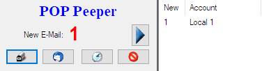

jdanniel wrote: Wed Apr 15, 2020 2:55 pm The question: Could you please elaborate on the "remind me later" option you referred to? What, exactly, does that apply to?
Here's what the PPv4 DTA looks like:
If you press the 3rd button (the clock), that's the "remind me later" option. After pressing it, the DTA will pop up again some time later to remind you that you have new mail pending. The time of the reminder can be specified under:
Tools / Options; Notification: "Popup reminder"

To answer your question:
As the screen-shot shows there is the optional "Remind me Later" button that can be used to close the DTA and remind you later regarding the message(s):
