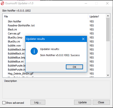

I'm not able to duplicate the problem with the skin notifier or SSL using auto-update. Using the free version (and this is with Shareware already expired), here's the process I took (for tracking):
1) Installed Ppv5 to a new folder, deleted the SSL files and installed Skin Notifier v4.3
2) Created a new ini file
3) Went to Help / About and pressed "Check version"
4) It told me there was an update for Skin notifier so I went through the process successfully:
5) Next, I added a gmail account
6) Tried to check mail it and got the expected error that SSL wasn't installed
7) Pressed the link that the error prompt gave me to auto-update. It also went smoothly.
