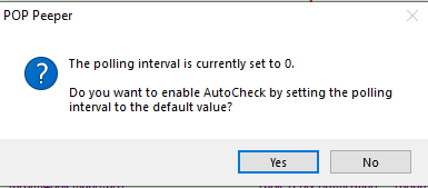

Ever since I graded from 4.5.3.0, every time I wake my PC from hibernate, there's a dialogue box on the desktop:
The polling interval is currently set to 0. Do you want to enable AutoCheck by setting the polling to the default value? Yes. No.
I've always had it set to 0.
I doubled checked the Lapse value in poppeeper.ini and it's zero.
I've been selecting No, which is a minor annoyance. But I'd like to be rid of the yes/no thing.

If you were to check the option "Autocheck" you will get this dialog:
If polling Interval is set to '0' produced this dialog if autocheck in enabled.png
If polling Interval is set to '0' produced this dialog if autocheck in enabled.png (4.93 KiB) Viewed 8392 times
Which I presume you will respond to with a "No" (since you do not want messages polled) hence the "Autocheck" will remain unchecked (disabled) in your case.
I'm confused by your mentioning you are unchecking (disabling) the "Autocheck" option (when you don't use this option in the first place). Based on my understanding as to how you use PP - this option would never be checked in your case.

That is exactly the dialogue (and as I described in my OP) that appears on my desktop when I bring my PC out of hibernation if Autocheck enabled is checked (green ball).
