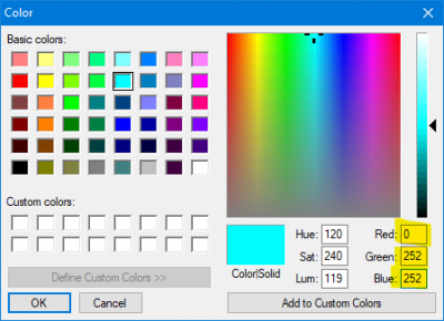

I'm testing this and I haven't gotten too deep into it, but I wanted to report that there does seem to be an issue with the background color -- some colors just don't work, but others do. For example, of the preset colors, the first 4 (after black) seem to work (the dark red, green, yellow, blue, and there may be more, that just happens to be what I tested so far); but some of the lighter colors do not work (ie. the bottom row -- blue, pink ,cyan); but yellow on the 2nd-to-last row works.

Ok, this will be fixed in the next update (current is v5.0.3). Thanks for reporting this!
I was on the right track with the dark/light colors -- there was a bad calculation that ignored a certain range of colors. This affects both fore- and background colors, so if you weren't seeing it with the foreground colors, I'm presuming it's because you were using dark colors for the foreground.
As for the current version, what you can do is make sure that none of the Red/Green/Blue values are greater than 252. It's more complicated than that, but that's the simplest rule to follow to avoid the miscalculation, and the resulting color won't be too far from the original.
For example, if you want to use cyan, then use Red/Green/Blue = 0/252/252 instead of 0/255/255 and you probably won't even tell the difference. Press the "other" button at the bottom of the color picker to specify these values.

Choosing a different color did work, so I'm good until the fix comes out.
