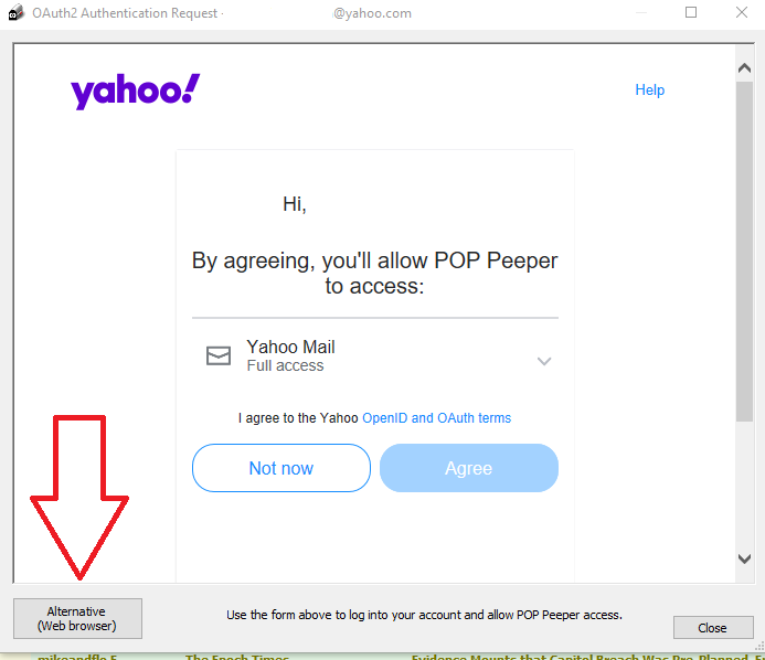

Ok that worked right up to the point where the page says "By Agreeing, you'll allow POP Peeper to access "Yahoo Mail Full Access"
with buttons that say "Not Now" and "Agree"
Clicking agree makes the button fade but the window does not disappear as it normally would.
and it sits there.
Clicking the "Close Button" a dialog pops up saying "OAuth was NOT successful. You may need to try an alternative method"

At the point where it fails (the button becomes "faded") then click on the following as illustrated in screen-shots below:
click on what is pointed out above (at the point the button becomes faded as you previously mentioned)

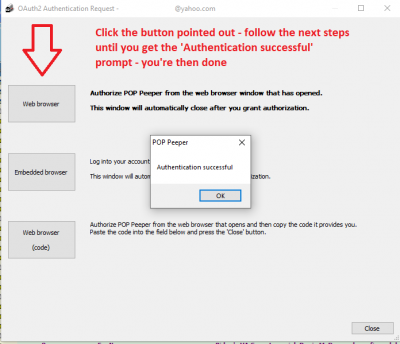

click on next step as illustrated if necessary and follow through with the ensuing steps until you get the message "Authorization successful".

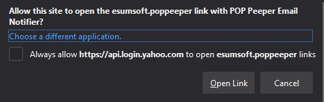

After you click the "agree" button in your webbrowser, you may see something like this:
(note: this is Firefox, and this looks very different than the last time I used this procedure)

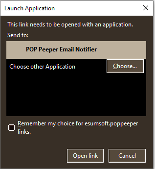

You have to make sure that you "open link" (or whatever your browser's equivalent is) -- what this is doing is sending the code from your browser to POP Peeper directly. After you do that, you'll get the "authentication successful" popup from POP Peeper.
As a last resort, you can always use the "web browser (code)" method -- instead of the webbrowser sending the code directly to POP Peeper as described above, you'll need to copy/paste the code from the browser into the prompt provided by POP Peeper. See lakrsrool's screenshot above to see how to access that method (ie. click the "web browser (code)" button istead of the "web browser" button).

My experience is when using the "OAuth2" button within the PP accounts edit window for Yahoo accounts -- nothing happens after clicking on the "Agree" button (illustrated in my 1st screen-shot in previous post) causing the "Agree" button to be disabled ("faded", as reported by Cynyster) - at which time if the "Alternate - web browser" button is clicked in that same window that has the faded "Agree" button (as illustrated in the previous 1st screen-shot in my previous post) this will produce a similar "Agree" button Interface within the browser to "allow PP to access Yahoo" that will ultimately lead to the following Interface:
After 'agree' button in PP is faded.png (6.65 KiB) Viewed 5198 times
at which time clicking on the "Open link" button (in this screen-shot example - which is a dialog that is presumably browser specific hence the dialog will likely vary in appearance) will result in the "Application successful" dialog in PP (in my case the Interface is using Pale Moon, my guess it is Firefox in the case of Jeff).
