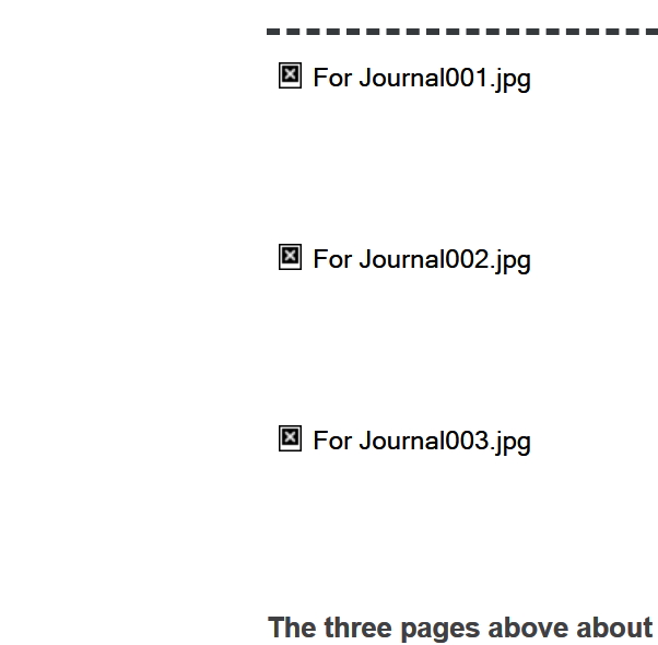

Can't view embedded pictures in email?
Some emails with pictures do not view only text of picture. See attached...
Any solution?
Thanks,
River
Any solution?
Thanks,
River

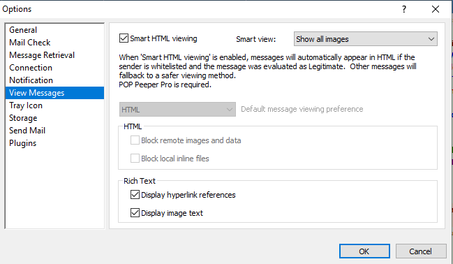

Can you please post a screen-shot of the settings you are using in the View Messages Interface (go to Tools>Options>Messages from the main PP menu).
View Messages example screen-shot:

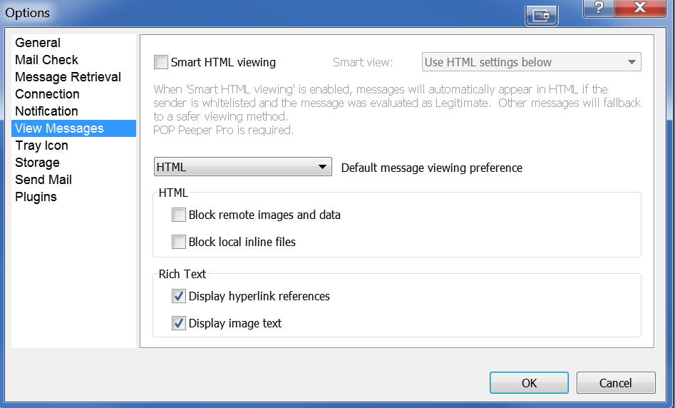

• FWIW, I've tried changing these settings....
• AOL
Are the images getting displayed when reading the message on the web (when logged into the Email Service using your browser)?
• Yes
What version of POP Peeper are you using?
• POP Peeper Pro v5.1.2

Have you tried the "View messages" settings as illustrated in my previous post. You may need to double-click on the banner illustrated in the screen-shot below to "Show images". If you are sure you can trust the site you can click on the "Confirm Legit" option on the upper-right side illustrated in the screen-shot to suppress (avoid) the "Double-click" banner for these messages. It is imperative that you are sure that you can trust sites before allowing the messages to view messages in HTML (images) including using the "Confirm Legit" option for all future messages from that sender.
