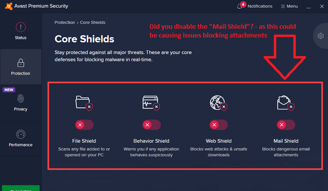

aguy30 wrote: Mon Dec 27, 2021 7:06 am security apps - I Avast Premium-it is always updating files and versions. Tried disabled but problem continues.
I'm a tad suspicious of Avast (there may have been a recent update that has changed things for you) - How did you disable Avast (temporarily)?
More specifically, within the "Protection" Interface you can disable the "Mail Shield" that monitors email attachments (see screen-shot below).
This not to say this one setting would necessarily be sufficient to rule out Avast (you might temporarily try disabling all Shields just for purposes to test for this specific PP issue).

It appears that you are correct. Disabled mail shield in the program and I was able to send yahoo emails with attachments without getting the error msg. (FYI: Disabling shields at the task bar icon did not fix the problem.)
Great, thank you.
Re: Yahoo mail send problem error
Good to hear that disabling the "Mail Shield" at the internal "Core Shields" settings level interface resolved the issue and it is also interesting that apparently disabling "Shields" via the tray icon did not produce the same result #-o - so thanks for reporting back with that important information regarding Avast. Image (it may be helpful to others using Avast!)
