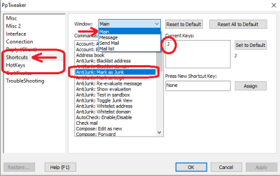

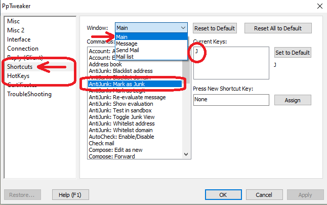

In "Tools">"PPtweaker..." you will find "Shortcut" key assignments - what I found is that marking messages as "JUNK" is already set by default from the "Main" PP window - so messages do not need to be opened (read) to do this (with this "Shortcut" already defined).
Screen-shot below displays the "J" key as assigned to setting messages to "JUNK" from the "Main" window (not the message window).
The "Window" drop-down list has "J" key assigned to the "Main" window (using the Window drop-down to specify what window the shortcut applies to).  If the "Message" window was selected then it would apply to the Message window as you stated.
I tested this and was able to set a message as "JUNK" from the "Main" PP window which is I think what you want to be able to do (as opposed to having to open the message). As illustrated in the screen-shot -- you can "assign" new or reassign old "Shortcut" keys as you prefer (using the box just below the "Current Keys" assignments and you have a choice 4 Interface windows available to you in the drop-down list to select from that would apply to the assigned keys).

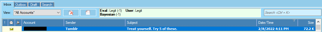

I'll illustrate what occurs step-by-step using screen-shots (note: I am remaining in the main PP window the entire time for each step below and at no time did I open the "View Message" window to read the message):
PIC-1 Before setting the message to "Junk" using the "J" shortcut in the main PP window (this is what you'll see, a "Legit" message):
PIC-1 Before setting message to 'Junk' using 'J' shortcut.png (9.4 KiB) Viewed 7952 times

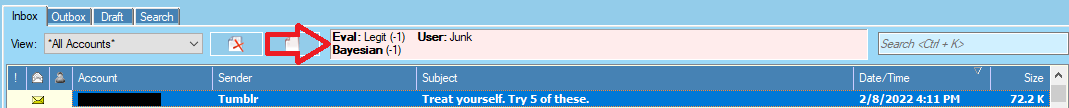

PIC-2 After setting the message to "Junk" using the "J" shortcut - Notice the change from the first screen-shot as the same message is now displayed as "Junk":
PIC-2 after setting message to 'Junk' using 'J' shortcut .png (9.64 KiB) Viewed 7952 times

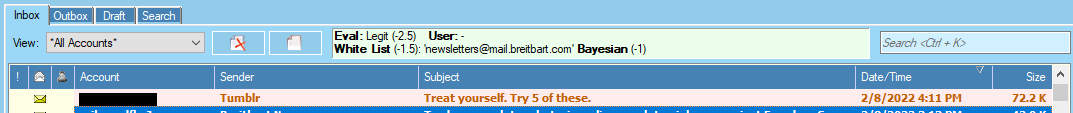

PIC-3 If you select another message in the Inbox - you will notice that the message is now highlighted with the color for "Junk" messages (while selected the color is obscured because the message is "selected" in the previous screen-shot):
PIC-3 Notice after removing focus 'selection' off of message the color is marked as 'Junk' in the Inbox.png
PIC-3 Notice after removing focus 'selection' off of message the color is marked as 'Junk' in the Inbox.png (11.05 KiB) Viewed 7952 times

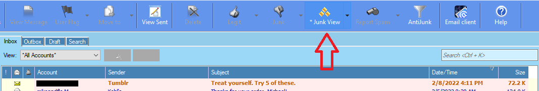

PIC-4 And finally to verify - clicking on the "Junk View" button produces a list of "Junk" message that includes this same message that was changed to "Junk" status via using the "J" shortcut in the main PP window:
PIC-4 as expected the 'Junkview' will display the message in the 'Junk' message list.png
Try it again - to see if you get these same results. (for this illustration - I never "Opened" the message to "View" it, remaining in the Main PP Interface window the entire time)
