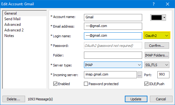

If you have received a notification from Gmail that you are using less secure signin, here's how to update your settings in POP Peeper.
1) Edit the account in POP Peeper
2) Change the "server type" to IMAP if it is not already set
3) To the right of your Login Name is a dropdown that currently shows "password" -- change this to "Oauth2" (if your version of POP Peeper is older than v5.2, then press the "Oauth2" button)
4) Follow the prompts to grant POP Peeper permission to access your email
5) After permission is granted, you will receive an "Authentication successful" prompt and you can now close the edit-account window
