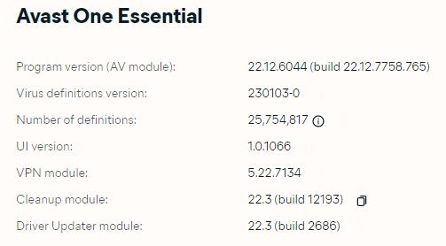

What version of Avast are you using? (there has been a recent topic posted in the forum in regards to sent messages not working in POP Peeper that turned out to be because of Avast).

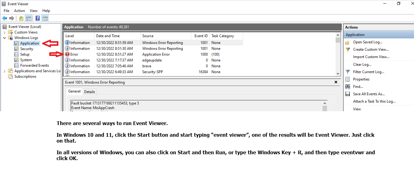

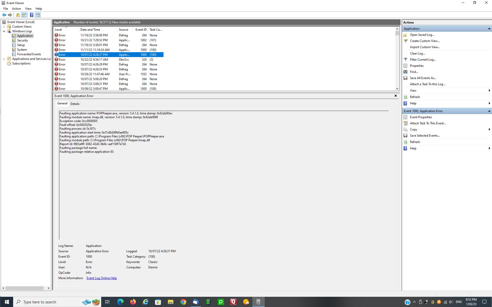

If your Windows Event Viewer is setup to do so (which I think is default) then you should be able to take a look at all the POP Peeper crashes by scrolling back through the events to get an accurate accounting as to when they occurred that might help out to know how often and regular this occurs.
Here is a screen-shot on how to use the Windows Event Viewer.
Click on screen-shot for better viewing (click on browser page-back to return to forum topic)

For Avast version see attached file "Avast Info.jpg"

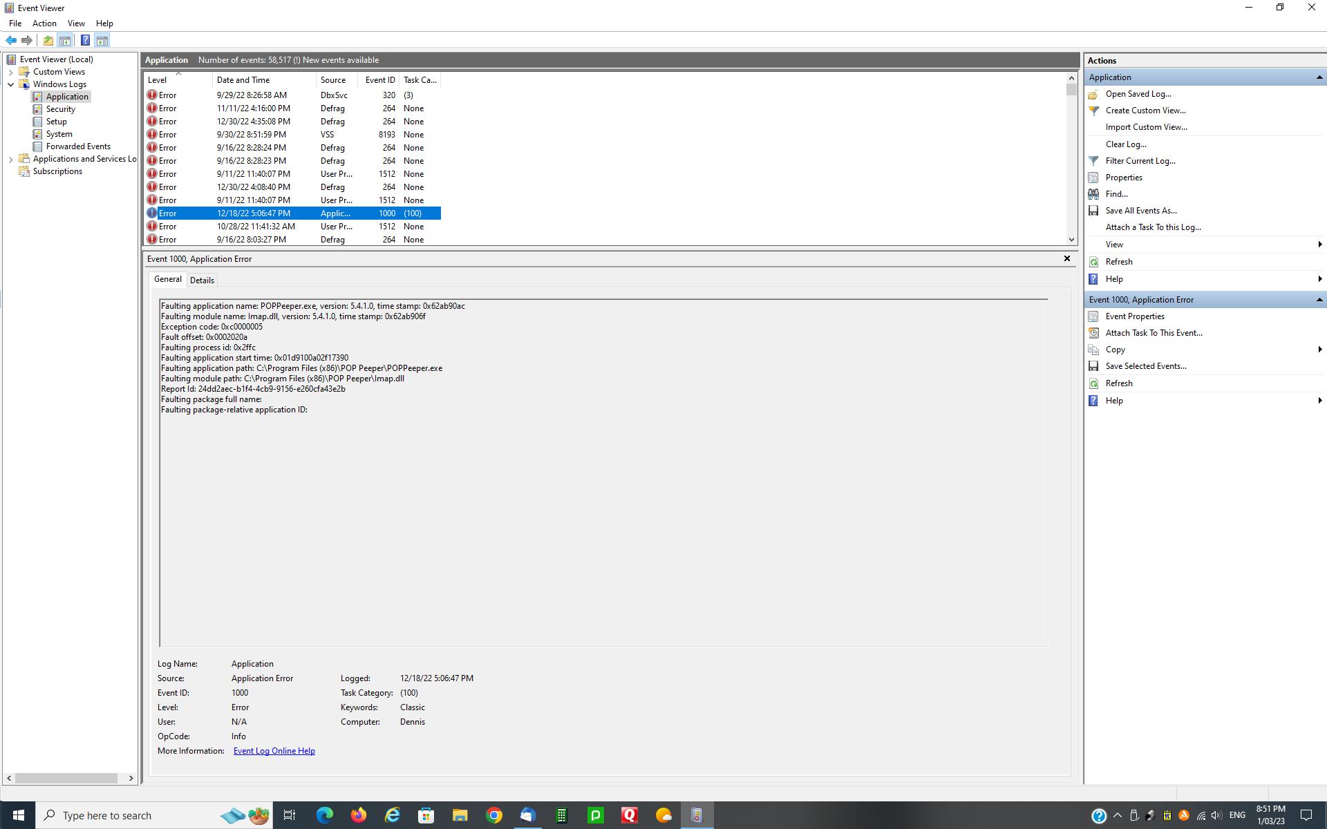

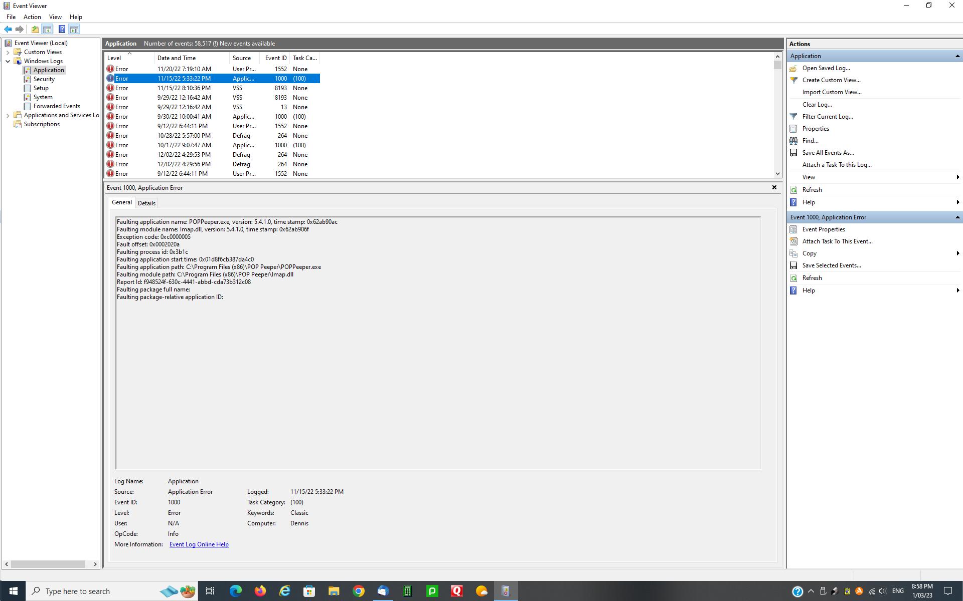

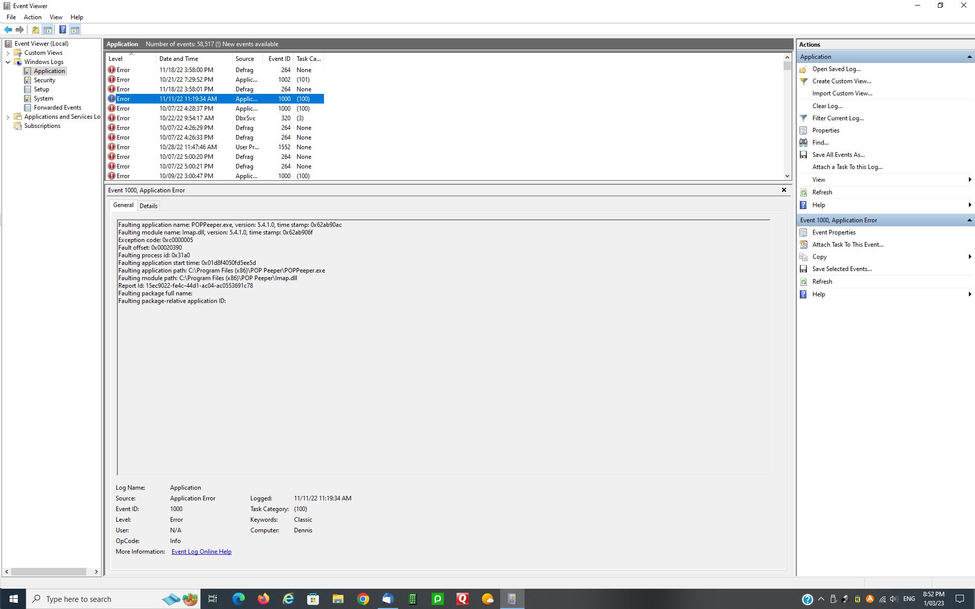

I screen captured the Windows Event Viewer items I could find. It will only allow me to add 3 attachments so the others will follow.
I don't observe the crashes as no indication is seen until I notice POP Peeper has vanished.
DennyM
Posts: 16
Joined: Thu May 29, 2008 8:41 am
Re: POP Peeper terminates
Post by DennyM »
Windows Event Viewer files continued...
DennyM
Posts: 16
Post by DennyM »

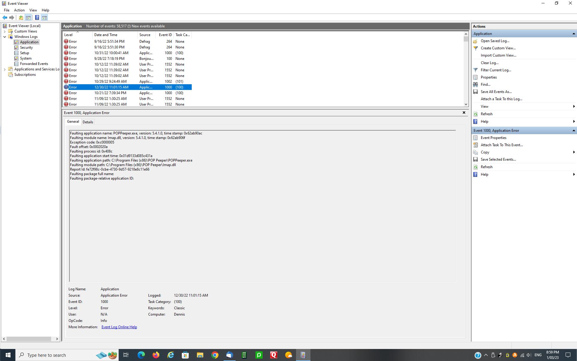

Last Event Viewer files...

Sorry for the misunderstanding, I had not intended that you should go to all the trouble of capturing/posting all of the POP Peeper crash screen-shots in the Event Viewer but rather just the crash dates would suffice (assuming the crashes were getting captured by the Event Viewer) as I mentioned "It might be helpful to post the dates as to when each occurred" (in order to try and determine any consistency, if any). :-o
However, thanks very much for all the effort put forward DennyM. :wink:
So the crash time-table works out to be the following:
10/07 - 02 days later
10/09 - 35 days later
11/11 - 04 days later
11/15 - 33 days later
12/18 - 12 days later
12/30 - so far 4 days have elapsed
Not much consistency as the crashes would appear to be essentially random. And I'm not finding any reports that the Avast 22 release is causing any app crashes.
