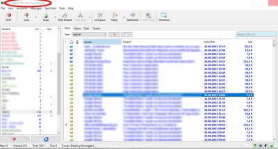

I'm a long term and experience used of POP Peeper monitoring over 20 mailboxes containing in excess of 100,000 mails.
I'm getting regular (2-3 times a week) lock-ups of the software (fails to respond, has to be forcibly crashed and re-started) and after weeks of trying to find a common denominator that actually causes the problem I think I may have found it. In simple terms I am re-sorting the entries in one mailbox at the same time as PP has started a mail retrieval run, where messages are pending deletion (i.e messages have been marked for deletion but are not actually deleted until the mail retrieval cycle) and those messages are being deleted as part of the run.
A few moments ago I tried to re-sort the messages in mailbox X (3700 messages) from date order to subject order. PP has frozen (and will have to be killed) - I now see that at the time I did this PP was in the middle of deleting messages from another mailbox as part of a retrieval run.
This last happened a couple of days ago, so I ran housekeeping on the database in case there were issues with the index, but it's just happened again.
Screenshot attached, although I am not sure it shows much.
Assistance appreciated!

ECourts -- thanks for the detailed diagnosis; it's very much appreciated!
Here's what I just tried: I added 10K messages to an account, and while PP was retrieving those messages, I would periodically toggle between which column was being sorted several times and then pause and then repeat. No problems occurred (based on your description, I wasn't necessarily expecting there to be).
Once PP had finished downloading the messages, I would mark about 10 messages at a time to be deleted, did a checkmail and then toggled the sort column between date and subject as quickly as I could. It took about 5 times, but then it happened -- PP locked up and the status bar says "deleting messages" just like you described.
CPU usage was at 0% during the lockup, which probably means that this is a deadlocking issue (e.g. 2 separate threads waiting on a resource that the other thread has already locked, so they're both waiting and cannot release the lock that the other thread needs to continue).
Again, thank you for providing the details needed to reproduce this issue. Being able to duplicate the error is crucial to fixing bugs.
