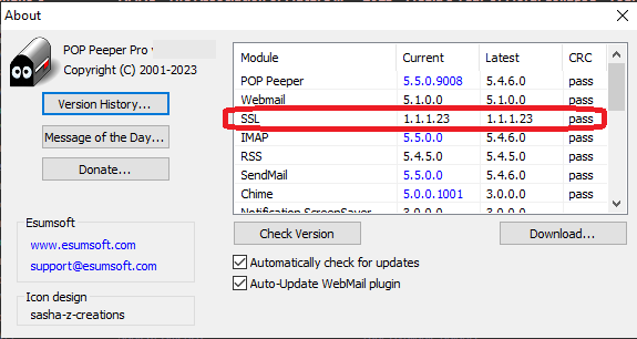

Check out "About POP Peeper..." (from main menu go to Help/About POP Peeper) and take a look at your SSL Module info (see screen-shot below) to determine if what you see is the same as in the screen-shot I've posted:
What a successful updated SSL should look like
If you see the same then you should be fine. :wink: (if what you have is not the same, then please post a screen-shot of what you have)

Again, assuming that POP Peeper can now process a successful "Mail Check" - I wouldn't be that concerned about the initial failed SSL update (in as much as PP ultimately did manage to successfully process the SSL "Auto Update" in the end).
