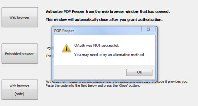

I tried Oauth2 yesterday but every time I log in they test if I'm not a robot and have to select images, then when they approve it, have to enter the password. (Nuts!) (Now you understand why I didn't have a Yahoo account earlier.) And after all this, I get the message OAuth was not successful.
"As of September 16, 2024, Outlook/Hotmail accounts will require you to use Oauth2". If this is the case, I have no use of Yahoo being on PopPeeper because it wouldn't automatically notify me of incoming emails, just like it's useless for Gmail.

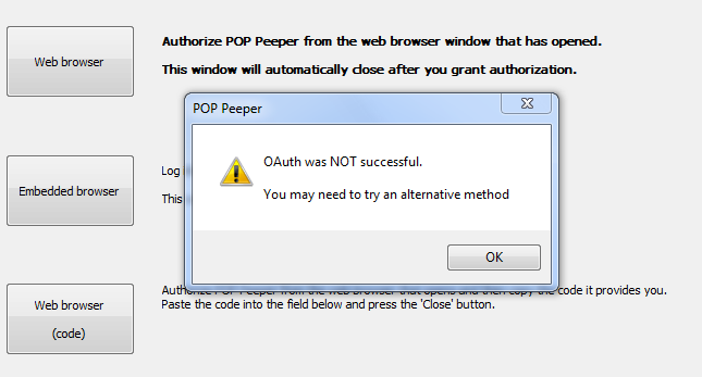

The "[SYS/TEMP] Server error" that you're getting is very likely due to not using Oauth2. The post you referred to was specific to Outlook (not Yahoo), but in fact, Yahoo has required Oauth2 for quite some time.
I tested Oauth2 on Win7 -- I had some issues but I did get it to work. I *think* I know the magic formula that made it work, as I'm able to duplicate the error and success by changing this back & forth, but full disclosure -- the first time I did it, it didn't work, though I suspect that there were other factors (just my way of saying, I'm pretty sure this will work, but not with 100% confidence, just 95%):
In the Windows start menu, type and open:
Internet Options
Select the "Advanced" tab
Scroll the list to the very bottom and enable:
- TLS 1.2
Press OK
Now try re-doing Oauth2 in your Yahoo account. If it doesn't work, try exiting and restarting POP Peeper. If it still doesn't work, fear not ranger, there is another alternative which we can proceed with.

Sorry for not getting back to you sooner—I needed some time to work on it. Guess what? I figured it out! The problem was that Chrome wasn’t set as my default program for Oauth2 to receive its initial authorization. Now it’s working perfectly. Thank you very much!

And it was important to check off TLS 1.2 in the Internet Options.

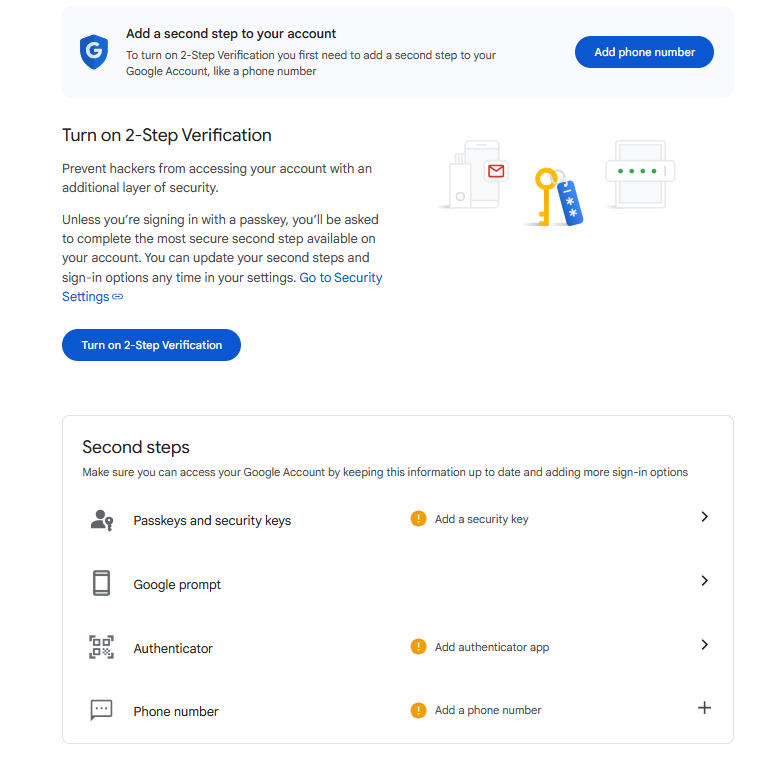

The authenticator app method only works after enabling two-step verification, which requires a phone number. I double-checked this.

NPeeper wrote: Wed Aug 14, 2024 9:48 am The authenticator app method only works after enabling two-step verification, which requires a phone number. I double-checked this.
I don't think that's correct. Here's what I get when I go to enable 2FA on one of my non-2FA'd gmail accounts:
The top part says: "To turn on 2-Step Verification you first need to add a second step to your Google Account, like a phone number"
key phrase: *like* a phone number.
If you press the "authenticator" option on the bottom (one of the available "second steps"), I assume this will be sufficient to enable 2FA. If not, (monopolistic joke retracted because... you know...)

I had noticed yesterday the words "like a phone number", but when I clicked on it, there wasn't any other option.
So now I got the 2-Step Verification turned on with an Authenticator. Now what? How do I get Gmail to open in Pop Peeper normal without having to run it as administrator?

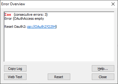

Greetings. This morning I am receiving this error on two PCs trying to connect to Yahoo mail via Oauth2:
2024-08-18 11_27_25-Error Overview.png (4.77 KiB) Viewed 17523 times
This is happening on two different accounts. Advice? I can access the account on my PC via regular Yahoo web-based E-mail using my password. The other PC uses Thunderbird which also connects via Oauth2; when I opened it, it asked for the Yahoo password which I supplied and was able to connect to Yahoo mail but I don't know if it stopped using Oauth2 for this (suspect that it did).

Re: PP Not Working With Yahoo Mail?
If you haven't already, you should click the "reset Oauth2" link and follow the procedure to re-authenticate with Oauth2. This will happen sometimes depending on the provider and certain conditions.
If it still doesn't work, it's likely a temporary issue on Yahoo's end. My Yahoo accounts are currently working.
