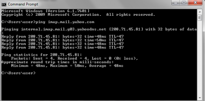

As I understand it, you are getting the the following error:
"account 1 Yahoo [1000: IMAP] ['imap.mail.yahoo.com' (993) SSL: 1] [Smtp: 'smtp.mail.yahoo.com' (465) SSL: 1] [Consec: 1]- Bad Connection"
when using "IMAP". So I am presuming that POP Peeper gets "stuck" for awhile using "IMAP" but eventually will stop attempting to "connect" and then produces this specific error, is this correct?
Have you enabled the "IDLE/Push" option? Generally "IMAP" works better with this enabled (lower right-corner of Account Edit interface).
What is your provider (i.e. AT&T, Comcast etc)?
It would appear that you are having other issues (possibly local to your area). Have you tried rebooting? This will clear cache which might help.
You may have security software or some other issues with your provider that is possibly interfering. Have you tried resetting your connections?
If your issue persists to look into this further you could try pinging the Yahoo IMAP Server.
Do the following steps to do this (see screen-shot example below):
1) Open a command/dos prompt (type 'command' into the start menu to find it)
2) Type in the command prompt: ping imap.mail.yahoo.com
Considering the issue you are having, you will probably get something like this (which would mean you are apparently having Yahoo IMAP Server issues for some reason, in which case take a look at the bottom of this post for a possible resolution using POP3):
Pinging internal.imap.mail.g03.yahoodns.net [208.71.45.81] with 32 bytes of data:
Request timed out.
Ping statistics for 207.46.11.202:
Packets: Sent = 1, Received = 0, Lost = 1 (100% loss),
Control-C
Notice the "Packets: Sent = 1, Received = 0, Lost = 1 (100% loss)" line.
What I get is the following (which does not "time-out" with errors):
Code: Select all
C:\Users\user>ping imap.mail.yahoo.com
Reply from 208.71.45.81: bytes=32 time=48ms TTL=47
Reply from 208.71.45.81: bytes=32 time=50ms TTL=47
Ping statistics for 208.71.45.81:
    Packets: Sent = 4, Received = 4, Lost = 0 (0% loss),
Approximate round trip times in milli-seconds:
    Minimum = 48ms, Maximum = 50ms, Average = 48ms
Screen-shot example:
If you do ping the server, notice the server name you get? There may be issues with this IMAP Server.....
As long as you ensure that "IDLE/push" is enabled for the problematic account, there is not much more that can be done. Alternatively you could try using "POP3", since in the case of Yahoo that protocol can sometimes be more reliable based on the historical record of Yahoo IMAP Server issues often occurring from time-to-time in some areas. Keep in mind of course that POP Peeper will have to re-download all messages each time you change the protocol so the first "Mail Check" after the change is made will necessarily always take longer (as I'm sure you have noticed :wink:).
asquirrel
Posts: 12
Joined: Thu Mar 05, 2015 1:33 pm
Re: Can no longer login to Yahoo mail
Post by asquirrel »
Hi lakrsrool!
You were right on about the security software. I'm running Peerblock and that was the cause of the problem. As soon as I disabled it I was able to reach the Yahoo servers. Is there a way I can still use Peerblock without having to disable it and still be able to reach the Yahoo servers? Thanks!
asquirrel wrote:Hi lakrsrool!
Peerblock is most likely interfering by blocking access to port 993 when using IMAP in this case. The default port setting to avoid block-lists in Peerblock is port 143 (the default IMAP non-encrypted port) and 80, but then if you use port 143 for IMAP you would not be able to use IMAP securely (use SSL) which is not desirable. This is because in Peerblock there's also a checkbox labeled "Always Allow HTTP" that is enabled by default when Peerbock installs. This option always enables connections over ports 80 and 443 of your PC, even if they're on your block-list.
A better way would be to determine what block-list is causing the issue or perhaps determine how to change a setting in some manner in Peerblock, however I am not familiar with Peerblock as I've never used it. You might take a look at this forum on Allow Lists that might help.
