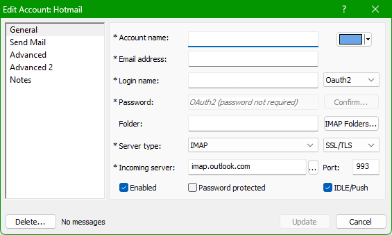

I have a question that may be related to this same issue.
Shouldn't "Push" make POP Peeper see a new email immediately regardless of the periodic check that POP Peeper does?
I'm pretty sure it used to. In fact, I think it used to see new emails before Microsoft Outlook saw them.
Now it only sees them after doing the periodic check. 5 minutes, in my case. It also only removes deleted emails after the periodic check.
I've attached a screenshot of my Hotmail / Outlook.com account settings. Email address info has been removed.

Protocol wrote: Sat Nov 19, 2022 7:16 pm Shouldn't "Push" make POP Peeper see a new email immediately regardless of the periodic check that POP Peeper does?
Yes (in general, when the message reaches the respective email accounts Server), as long as "Push" is supported by the Email Provider and there's not any issues with any Servers involved or issues with either the Mail Server or Email Client or any kind of software security interference that might possibly impact the "Push" function.
As to your protocol settings (screen-shot) - you are using the same settings that I use for all 17 of my outlook.com accounts, none of which (to my knowledge) have had any issues similar to what you have described (see below).
Edited to strike out comments above in as much as upon testing Push specifically, I've found that Outlook.com accounts are not working after all (I had presumed otherwise based on messages getting retrieved via Scheduled Mail Checks).

Protocol wrote: Sun Nov 20, 2022 10:46 pm Push is working for you, but not me.
My mistake, I should have tested for "Push" - I've been regularly getting outlook.com messages, so assumed it was OK. Upon specifically testing for "Push", I can confirm as well that outlook.com "Push" does not appear to be working after all (all messages are getting retrieved via "Scheduled" Mail Check polling intervals as it turns out). I should have checked this out in more detail based on Jeff's post (if nothing else), sorry for the confusion. :oops: (it seems we're all in the same boat w/out "Push" working for Outlook.com accounts).
