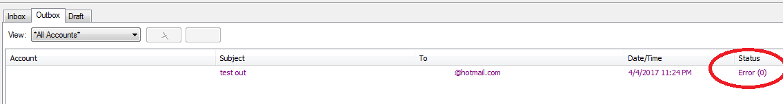

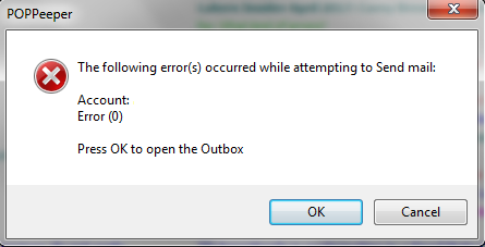

And as far as sending mail, if you use Webmail ("Hotmail/Outlook") and for this account do not have the "Send option" in the "Send mail" tab set to "SMTP" but instead it is set to "Webmail" and then try to send mail you will get a "Error (0)" error when sending a message and the message would then remain in your PP outbox where it will stay until you change the "Send option" setting to "SMTP" at which time the message will successfully send from your PP outbox. Below are examples:
The error you get sending messages in Outlook.com with "Server type" set to "Homtail/Outlook" (Webmail) with the "Send option" set to "WebMail" (instead of ("SMTP")
The error generated will be "error (0)" and message will remain in PP outbox until "Sent option" is changed to "SMTP".
PP Outbox error 0.png (6.33 KiB) Viewed 19679 times
While testing this I found that attempting to send the message from the PP Outbox after changing the "Send option" to "SMTP" I continued to get this error: "Send Mail: Login Error: Auth XOAUTH2

Re: Hotmail: Errors Retrieving Messages
Post by etienne53 »
Guys, I hate to say this because I've used Pop Pepper for years and really like it, but not only am I still having trouble with Pop Peeper with my Hotmail account, I'm NOT having trouble with Mailbird fetching email from my Hotmail account. If the trouble lies with Microsoft's servers, shouldn't the problem be universal?
