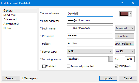

Setup (POP Peeper) - See the screenshot below for reference. Of note, the following values need to be changed:
- Use "Password" method
- Use "No SSL"
- Port: 1143 (change this after setting to "No SSL")
- Incoming server: localhost (or 127.0.0.1)
- Folders are supported, but the list DavMail returns by pressing "IMAP folders" is not complete. In this example, I have a valid folder named "Archive" for which I can successfully access messages, but it is not listed by "IMAP folders".
- To access a shared mailbox, use the following format for the "Login Name": mydomain/my_email_adress/SharedInbox_address
