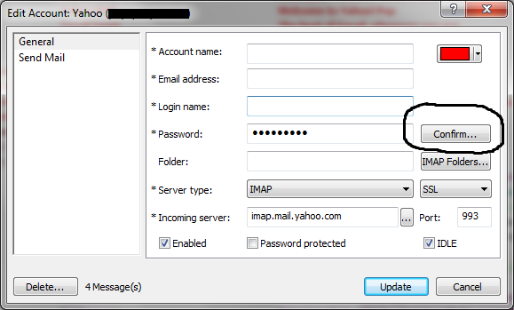

Hi shank, did you "confirm" the password change(s) in your Pop Peeper "Edit Account" interface :?: (refer to image below, which is an optional step to help verify that your password change is what you intended).

CLICK ON "CONFIRM" BUTTON TO CONFIRM PASSWORD

Yes - the confirm password function was used, has no impact on the issue.
