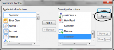

The "Reset" button in the Customize Toolbar window is for the purpose of resetting the toolbar back to the "default" toolbar (so the "Reset" button did what it is supposed to do). Have you been pressing the "Reset" button (see image below) with the idea that this is supposed to reset the toolbar to the changed setting so to speak?techmanc wrote: I did notice something else that at some point I had already changed the toolbar with different ones and once I did a reset it went to default icons that changed back to my current setup so the toolbar seems suck on that particular set of icons.
If you want the toolbar to stay the way it is with the changed icons then do not press the "Reset" button. After changing your toolbar by adding the "Buttons" you want just "Close" the window. If you then "Exit" POP Peeper the toolbar should retain those changes.
If after exiting POP Peeper the Toolbar is still not retaining the buttons you've added then check once again to determine if the ".ini" file is "write protected". Right-click on the .ini file (where you moved it, the file name will be "pop peeper" and file type column will say "configuration settings"), then click "Properties" and make sure that the "Read-only" attribute is not checked (if it is checked then uncheck it and click "OK"). Also at the bottom of the "Properties" window, does it say anything about the file being blocked and allow you to unblock it? In other words, if you see an "Unblock" button then click on that button to "unblock" the file. Now make Toolbar changes and see if the changes hold after exiting POP Peeper.

The poppeeper.ini file is not write protected. The reason I pressed the the reset button was to see if I was already using the default ones. I was not and they changed to them. Then when I exited Pop Peeper it had same toolbar I have now. The toolbar I have now was customized in the past apparently but it wont change now. I get the same toolbar no matter what I do I have now! Also the read the message of the day keeps reappearing after I read it with same message so somehow that not working right either.lakrsrool wrote:The "Reset" button in the Customize Toolbar window is for the purpose of resetting the toolbar back to the "default" toolbar (so the "Reset" button did what it is supposed to do). Have you been pressing the "Reset" button (see image below) with the idea that this is supposed to reset the toolbar to the changed setting so to speak?techmanc wrote: I did notice something else that at some point I had already changed the toolbar with different ones and once I did a reset it went to default icons that changed back to my current setup so the toolbar seems suck on that particular set of icons.
