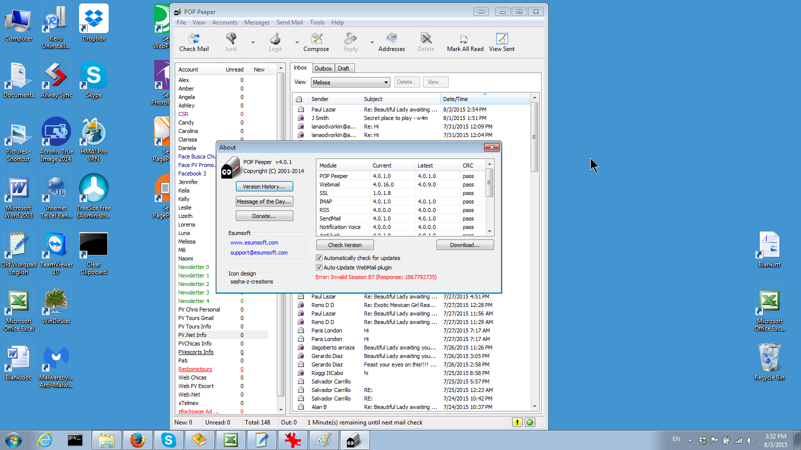

I updated the option to include beta releases but I am getting an error "Invalid session 87 (Response 1701332732)
and it isn't showing the 4.1 beta....what to do?

I get this error when I click "Check version" on the About window. I have version 4.0.1. I have stopped and started POP Peeper a few times.. I just tried it on my backup computer...same HP Laptop running Win 7 Ultimate and I get the same error. Can you just send me a download link for the update or shall I send you an error log. I forgot how to get the environment info for POP Peeper.. would that help?

As for the problem you're having getting the beta -- that's very strange. Could you upload a screenshot of that so that we can see the context? Is the error in response to you pressing the "check version" button, or on the prompt that follows that?

I am enclosing the one that shows the beta version download problem. I would prefer to send the others privately and I'm sending them to you at the support address.
By the way the beta version check occurs immediately after I click the "Check version" button. Nothing happens after that.

Back to this invalid session error -- there must be something blocking POP Peeper's access to esumsoft.com as I also see that it says that the latest webmail version is v4.0.9; which was from March 11. So the problem probably occurred sometime between March 11 and March 26 (when v4.0.10 was released).
This will also prevent the checks for new versions and updates for webmail (as I'm sure you've discovered since you have a more recent version than what it says is the latest).
There is another way to check if PP has a valid connection to esumsoft.com which *may* provide more information: on the main menu, select File / Error overview and then press the "web test" button. It should respond with "server response: 200" and a timestamp.
