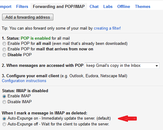

2) Login to your Gmail account on-line in your browser, Click on the "Gear" in the upper-right corner of the window and select (click on) "Settings", select (click on) the "Forwarding and POP/IMAP" tab and determine if the "Auto-Expunge on - Immediately update the server. (default)" is enabled (selected), see image below. If this option is not selected then select this option as seen in the image below and click on "Save Changes".
If either of these settings above needed to be changed then try your test scenario again on that specific problem account as before and see if this helps. (considering that these are default settings I'd be surprised to find they needed to be changed but thought it best to check anyway to make sure at this point)

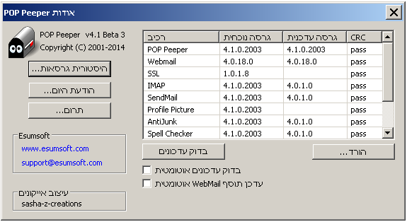

3) And finally from the PP main interface, please click on "HELP" > "About Pop Peeper" and past a screenshot of this information (just to verify what we're using) in your next reply in this topic. For help to attach a screen shot refer to: How to take a screenshot & attach/insert it into your post

Well, the setting in Gmail was "Auto-Expunge off".
I'm absolutely sure I never changed that setting. Really strange.
So, no difference between v2002 and v2003.
With "Auto-Expunge off", I would have gotten the same result with v2002 at some point.
- Or is there a better explanation to the consistent different behavior I noticed yesterday?

Well, I apologize gentlemen. It just happened again, and this time with "Auto-Expunge on".

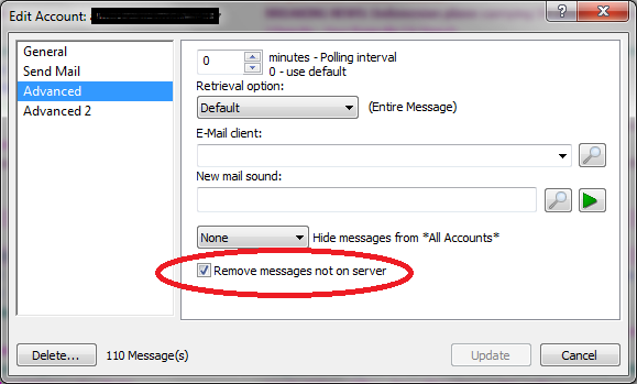

Moshe, can you please do this for me, in the PP main menu go to "Tools" > "Options" > click on the "Storage" tab and post what your "Data path" is set at (or you can post a screen shot if you like), it should most likely look similar to the following: "C:\users\[username]\AppData\Roaming\POP Peeper\POP Peeper". (I'm wondering if there is something peculiar to your PP installation, although errors would typically occur in this case as well)

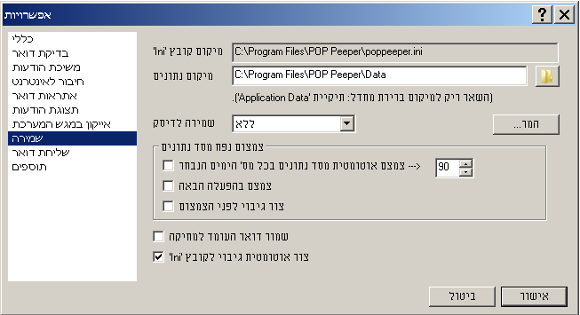

I've set Data location to C:\Program Files\POP Peeper\Data.
I find it more convenient to deal with one location.
I've used that setting for years and never had a problem.

It is definitely recommended to NOT set any PPv4 version data files to any folder paths that include folders that are protected by Windows "User Account Control" (UAC), i.e. folders using the path of "C:\Program Files (x86)" or "C:\Program Files\" (note: By default, C:\Program Files, C:\Windows are UAC protected.). More recent Windows OS programs are not allowed to write in the "Program Files" folder as a result of UAC. Windows treats PPv4 differently because of UAC, on the other hand PPv3 was not "UAC-aware" so Windows would store data files in the VirtualStore folder instead of the Program Files folder. The upgrade to PPv4 is intended to correct this issue of using UAC protected folders by moving the data files into the AppData folder. Which btw, is why I had said in my previous post that the PP "Data path" should most likely look similar to "C:\users\[username]\AppData\Roaming\POP Peeper\POP Peeper".
This is up to you however as I'm not certain your specific issue is caused by Windows UAC restrictions but I would definitely recommend you consider do the following in order to avoid using UAC folders regarding your PPv4 install:
1) Exit POP Peeper
2) Move the ini file from "C:\Program Files\POP Peeper\poppeeper.ini" to "%userprofile%\AppData\Roaming\POP Peeper" (without the quotes)
3) Restart POP Peeper
4) From the PP main menu, go to "Tools" > "Options", select "Storage" tab and delete the value for the data path which will reset the data path value to the AppData folder
ADDENDUM: Even if UAC is not directly impacting your specific issue, leaving the poppeeper.ini file in the path location where you have it now will generally result in PP failing to save (retain) critical account settings that are maintained in that file. Click HERE for a link to a topic that provides a more detailed explanation regarding this issue including sub-links in the linked topic where Jeff provides additional specificity regarding this topic, more precisely describing what to do step by step to avoid PPv4 from using UAC protected folders for PPv4 data.
1) Exit POP Peeper

Re: Thank you for PP v4.1.0.2003
Great work Moshe, I was able to duplicate the problem. It is a matter of only one message in the inbox and in that case the message remains in the PP inbox after deleting the message from the Client Email.
We'll have to wait on Jeff to look into this, your probably right about your "bug" conclusion.
The error was not related, just a random error.
