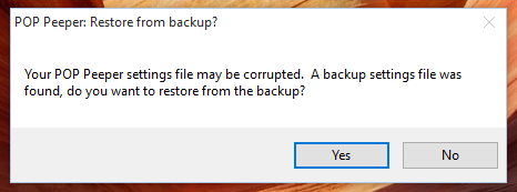

I've had PP for for a long time and it's worked flawlessly, I just upgraded to Pro/Plus and now every time I start my computer I get this pop-up message...
"Your settings file may be corrupted. A backup settings file was found, do you want to restore from the backup?"

If this message involves Pop Peeper it should read as follows: "Your POP Peeper settings file may be corrupted. A backup settings file was found, do you want to restore from the backup?"

Yes, that's exactly what it says. It DOES say POP PEEPER up at the top of the notification. I really don't want to restart my computer right now so if you really need a screenshot I can do it later.

Just in case, here's the notification.

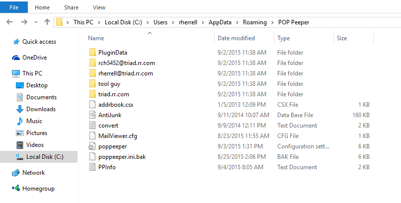

hm, ok, your ini file is in the acceptable "appdata" folder, so the file is not write-protected due to UAC as I was expecting. However, it's possible that the file is still write-protected. What you'll need to do is open Windows Explorer to the folder containing the ini file:
C:\Users\rherrell\AppData\Roaming\POP Peeper\
This folder is hidden by default, so you can copy/paste that into Windows Explorer's address bar and press <enter> to access it directly.
Then, right-click on the poppeeper.ini file (make sure it's not the .bak file *) and select "Properties"
Make sure that "Read-only" near the bottom is not enabled; if it is, uncheck it and that's the problem.
* - If your Windows Explorer is hiding file extensions by default, you may want to enable it to make sure that you're accessing the correct ini file. From Explorer's menu, select Tools / Folder options; View tab; then make sure that "hide extensions for know file types" is NOT checked. That's the process for Win7, I think later versions (win10, anyway) have a slightly different method... let me know if you can't find it and what OS you have.
After looking at your screenshot again, you probably do have Win10, so for that you just need to click on the "view" menu and you should see "file name extensions" checkbox on the right -- enable that.
All I have is the .ini.bak file, is this the problem, i.e. no seperate .ini file? I searched for poppeeper.ini but all it returned was the .ini.bak file.

The file we're after is the file immediately above the poppeeper.ini.bak file. ie. its name is "poppeeper" and the type is "Configuration settings"
However, based on the fact that both file sizes are 6K, it's possible that the backup file doesn't have any accounts in it either.
I apologize for the problem, but at this point it would probably be easier just to setup those accounts again. It looks like you only have 4 accounts, which is certainly not as bad as it could be. If you want me to investigate it a little more before you resort to that, send me your poppeeper.ini.bak file and I'll see if it has any of your account information in it. Email it as an attachment to (support at esumsoft dot com) -- it may contain some personal information, which I will ignore, so do not post it on this public forum.

rherrell wrote: All I have is the .ini.bak file, is this the problem, i.e. no seperate .ini file? I searched for poppeeper.ini but all it returned was the .ini.bak file.
Have you done a right-click on the file named "poppeeper" with file type "Configuration sett..." ("popeeper" file displayed in your screenshot w/ modified date of 9/3/15 directly above your "popeeper.ini.bak" file) and selected "Properties" to make sure that "Read-only" toward the bottom is NOT enabled, if the "Read-only is checked then uncheck it and click "OK". (since you have a total of only 4 accounts then it's possible that the small 6KB file size may actually be entirely appropriate).
