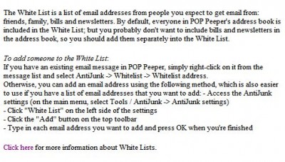

I am usung version 4.01 of the pro pack (POP version.jpg). I want to manually add an email to the white list. I followed the instructions in the help file (POP Help_1.jpg), but the button described in the help file does not match the interface on the White List Page (see White List Page_3.jpg). There is no button. What am I missing?
Well since I cannot upload more than one attachment, it will be hard to understand my problem There is no button on the White List Page as described in the help section. I can upload several screen shots including the shot of the various plug ins that are enabled if allowed.

There's a typo. It should read (change marked bold):
Otherwise, you can add an email address using the following method, which is also easier to use if you have a list
of email addresses that you want to add:
- Access the AntiJunk interface (on the main menu, select Tools / AntiJunk -> Main interface)
- Click "White List" on the left side of the settings
- Click the "Add" button on the top toolbar
- Type in each email address you want to add and press OK when you're finished
