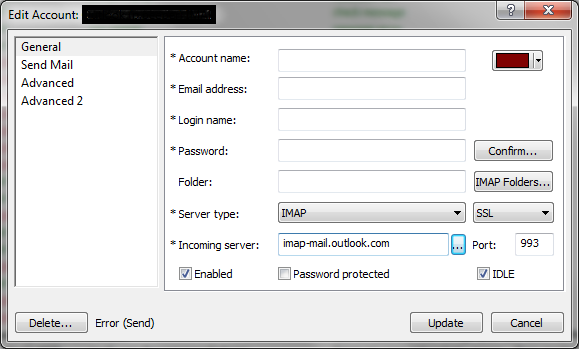

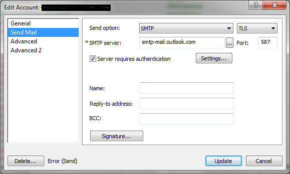

In an attempt to duplicate exactly what you were doing (I've never used the "Discover Server" button) and I got the same "connection error". It would appear that the test is possibly testing the wrong Secure Connection protocol using this procedure to test the Server Connection. What you should do is just enter exactly what I had posted before (see below as well).
Please just enter what you see below in the two images. Then right-click on the account and select "Check Mail" from the context menu (note: I got a "Select Command is not permitted in current state NotAuthenticatedServerError" error the first time I did the "Check Mail" so if you get an error don't be concerned just do another "Check Mail", the Mail Check should be successful ultimately using the settings illustrated below:
RIGHT/CLICK ON ACCOUNT: SELECT "EDIT" > ENTER EXACTLY WHAT YOU SEE FROM "SERVER-TYPE" DOWN IN THE "GENERAL" WINDOW AND WHAT YOU SEE AT THE TOP OF THE "SEND MAIL" WINDOW:
Enter exactly what you see, entries that are blank are where you would have your other account information.
Enter exactly what you see, some entries are blank for security reasons
