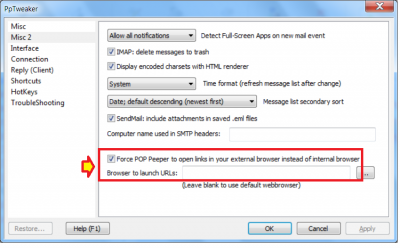

4. From the PP main interface, click on [TOOLS] > [PPTweaker] > Misc2 tab.
You should now see what is shown within the red box in the screenshot I've included below.
PP > TOOLS > PPTWEAKER > Misc2
4a. Is the box check-marked where it says, "Force PP to open links in your external browser..." ?
4b. Do you have anything shown in the box beside, "Browser to launch URL's"? if so, please specify. Alternatively, you can just include a screenshot of what is shown on your end if you prefer. Instructions for doing so can be seen HERE.

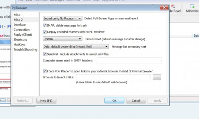

4. My PPTweaker screenshot attached
