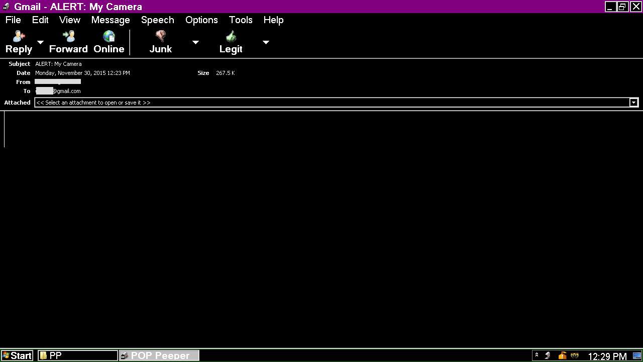

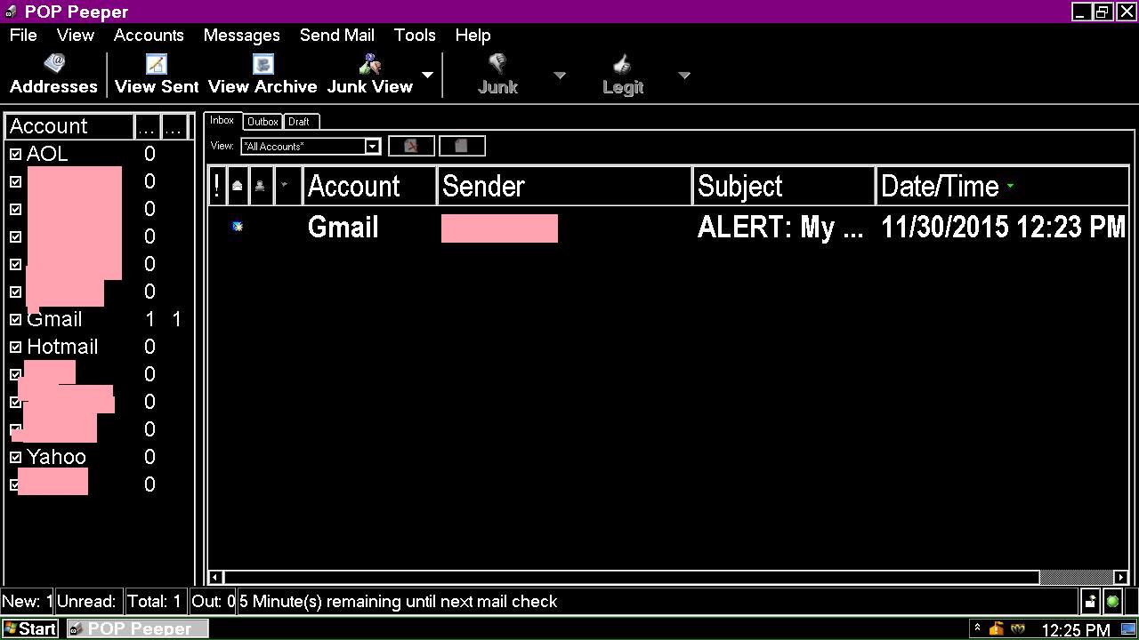

BEFORE
1) I click Message (Fig 1)
2) empty message (Fig 2)
3) click 'online'
4) message said cookie (see top of page, post #1)
that wrong.. I tired

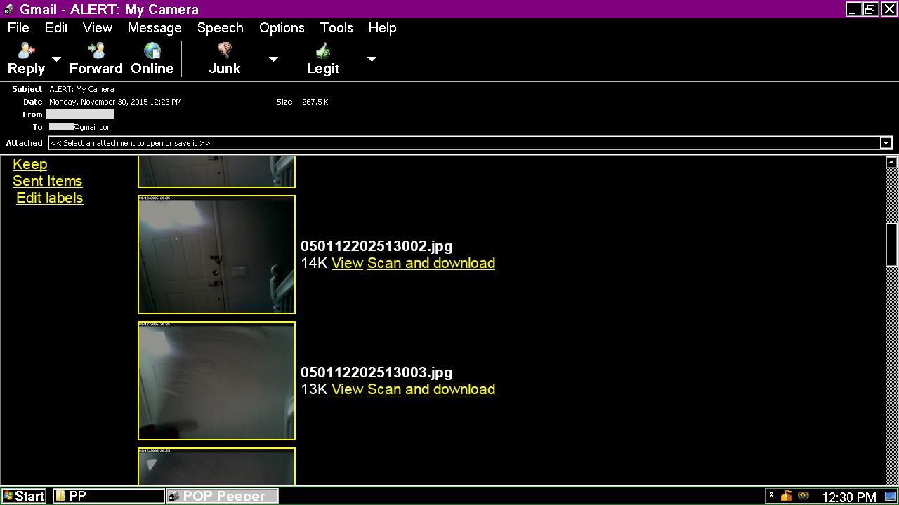

FIX
5) click link and click sign out (one time)
6) re-run
AFTER
3) click 'online'
4) I got message with Picture (Fig 3)
Every test every online, no problem!

Re: Problem Cookie for Online GMail
rhr wrote:@Jeff okay
BEFORE
2) empty message (Fig 2) <---- What did you do to get the empty message? You did get the message in step1, what did you do to change this?
3) click 'online' <---- Where and/or what are you doing when you "click online"? (please provide more detail)
4) message said cookie (see top of page, post #1) <---- This is a Gmail account message, right? And what did you do to get this message?

AFTER
3) click 'online'
4) I got message with Picture (Fig 3) <---- Fig 3 "message" displays no "picture", do you mean when you open the message you get pictures?
I know it is weird and I don't understand too
