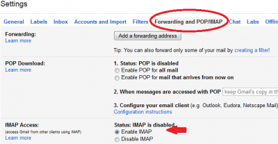

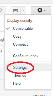

Re: 4.1.1 imap read unread state not working
Do you have IMAP enabled in your Gmail account(s)?
Log-in to Gmail on the web using your browser and check on the following:
1) In Gmail Settings:
Click on Gmail Settings
Google email settings.png (8.18 KiB) Viewed 12239 times
2) Enable IMAP in "Forwarding and POP/IMAP" column of Gmail Settings page:
In the tab circled make sure you have IMAP enabled
3) Be sure and Click on the "Save settings" button at the bottom of the page!
