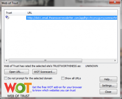

As to your description it "opens the link itself", I'm wondering if WOT security is what you are referencing (see image below): If this is the case, and you trust the website you can click on the "Open URL" button which will then open the linked webpage in your (default) browser and keep in mind that you can also check the box "Do not prompt for the selected domain" if you do not want to see this prompt again for websites that belong to that specific domain that you trust.

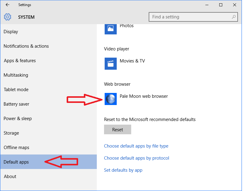

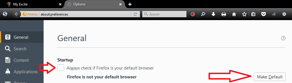

I use WIN7 myself, but I do have a laptop with WIN10 and have no problem setting "default apps" in this OS (refer to Method #2 for this). I use Pale Moon as my default browser but have no problem setting FF as the default via the browser setting (refer to Method #1 for this) which is really the easiest approach.
The "How to" for the first two more preferable methods previously posted:
Method #1) Just go to Firefox "Options", you will find right at the top of the "General" tab the settings for this. If you click on the "Make Default" button this will get what you want which is to make FF your default browser (first thing you will see in FF "Options"). Also if you click on the other "Startup" option pointed out then in the event your default browser might inadvertently get changed (like in you case apparently) then Firefox will always prompt you if Firefox is not your default (virtually all browsers have these settings by the way). Method #2) If you follow the steps outlined on this http://www.howtogeek.com/223144/how-to- ... indows-10/ website you should have no problem setting the default browser in Windows 10. You would set your default browser to Firefox instead of what you see (Pale Moon) in the screen-shot below of course by clicking on "default apps" then clicking on "Set defaults by app" and selecting "Firefox" from the list of apps displayed. If you were to use either of these two preferred methods then you should remember to set POP Peeper Method #3 back to the setting that it was previously (that is check the box as opposed to providing a direct path to the browser of choice as you apparently did).
