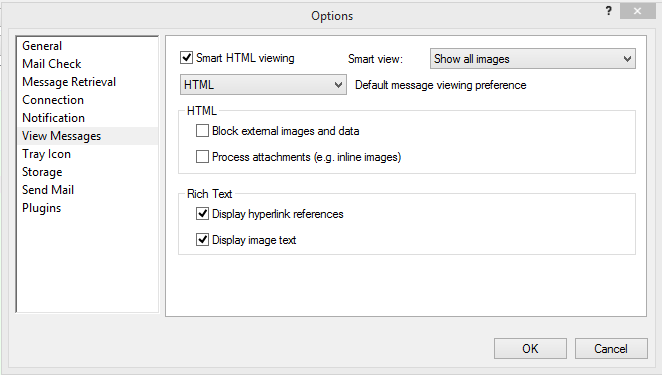

Under Tools / Options / View Messages, there is an option, "Smart View" with the choices:
- show all images (default)
- Use html settings below
If you've changed it to the 2nd option, then you could get part of the behavior you've described. Before you change that, though, could you tell us what settings you have on that window? Take a screenshot if it's easier (instructions).
Also, for the sake of consistency, do you know if the images in the message(s) are file attachments in the message or stored remote on a server? My testing involved remote images, and it could make a difference if yours are local.
However, I've tested this scenario, and even if I mark the message as legit and the setting above will block the images, I still see the option to "double-click to unblock" immediately -- no need to close the message window. So that's one thing I can't explain without further information.

I've attached a screenshot of my settings. The images are stored on a remote server. If I reopen the message a third time it is still marked Legit. I do see a green thumb after I've marked the message as Legit the first time.

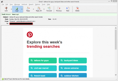

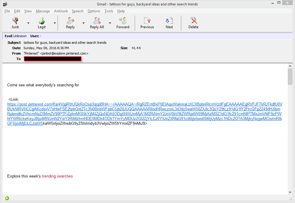

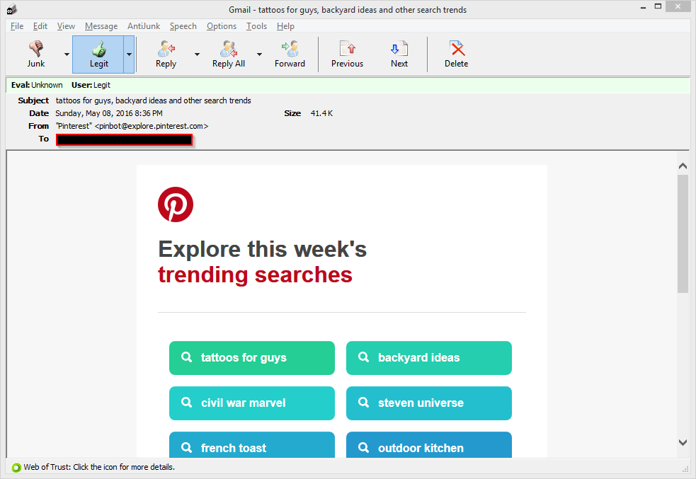

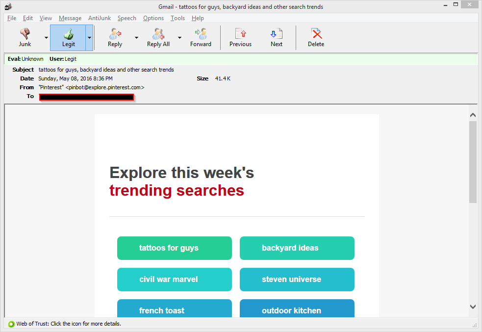

I've attached a few screenshots showing what I see when I [1] open a message, [2] mark it Legit, and then [3] reopen the message.

Ok, I'm not sure what exactly happened, but all of a sudden, I'm able to duplicate the problem. I'm a little confused because I thought it was working as expected, then I went into test in Win10 and Win8 VMs, and it started working more like you describe; went back to my native win7 and it also started working like you describe. So there's definitely something I can look into now.
However, there's a couple other things:
1) In your first screenshot of the View-message window, there's no yellow "double-click here to open HTML" banner (it should be below the "Eval: unknown" banner). I've been racking my brain to remember if I had somehow made this optional; I've even taken a quick look at the code and as far as I can remember/tell, there's no option to disable it. Do you ever see this banner, do you know what I'm talking about (I can show a screenshot if necessary). I watched for it in all my various OS tests, and it always appeared in the equivalent of that screenshot.
2) My tests followed the procedure that you mentioned, that is, press "legit" and it loads HTML but no images; close and re-open the message and it works as expected. You had previously mentioned that "legit" wasn't sticking after you opened the message the 2nd time. Do you think that that is still a problem or perhaps you inadvertently pressed it again thinking that it would re-load the HTML page? It is a toggle, so if it's marked as legit and you press it again, it will "unmark" it as legit.

#1. The yellow banner was there, but after I clicked "Legit" the yellow banner went away. When I clicked "Legit" again (deselected it) the yellow bar didn't come back. Apparently, that is when I took the screenshot. I guess it would make sense for the yellow banner to come back though after unmarking a message as "Legit". Redownloading the message or reopening the Message window makes the yellow bar reappear.
